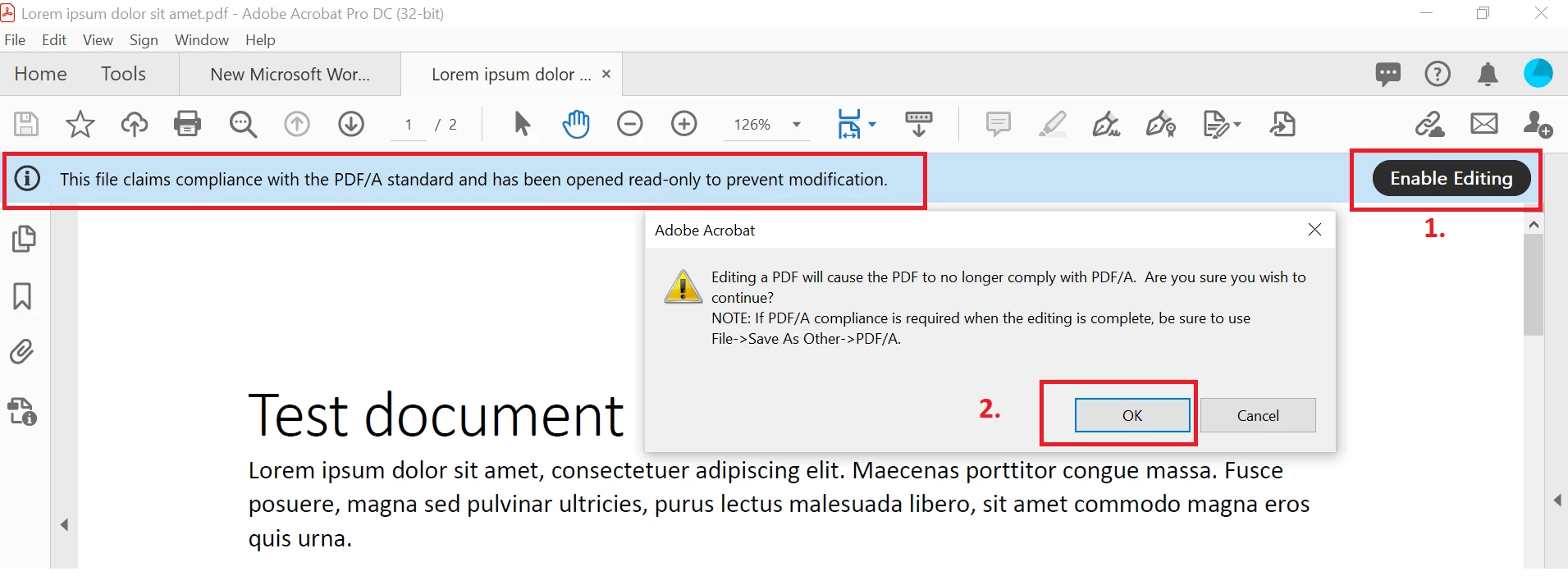

Thank you for sharing the video recording and the MS Word and PDF file. I have tried to reproduce the issue on my end and below are the findings:
1. Once creating PDF from MS Word using the Acrobat ribbon on the top , the PDF created is PDF/A compliance and editing is disabled.
2. After clicking on Enable Editing Button and saving the PDF an non PDF/A compliance i was able to send the document for comment easily, please check the screenshot below.
