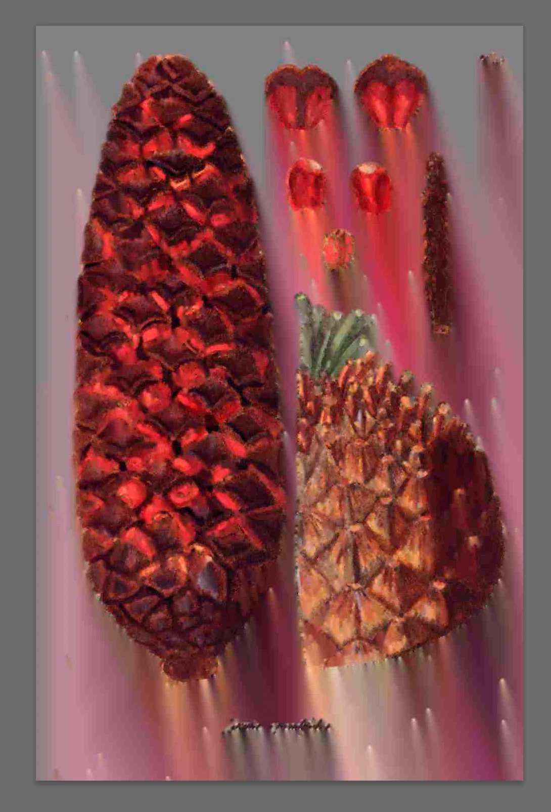

I get a "smearing" effect when I batch export all pages in a PDF to JPG.
  • January 14, 2022
  • 4 replies
  • 4001 views
I have a PDF in which each page is an image. I want to save each page as a JPG.
When I batch export to JPG, I see smearing on the JPGs. What can be causing this? I am subscription-based and using Windows 10.
I have posted a "before" PDF and as "after" JPG. Thank you.

I can export your attached pdf to .jpg without any problem (on a Mac), I noticed your pdf is a PDF/A, is this intentional? Can you convert an individual pdf to image? (before you combine). Check for Acrobat updates, (Help> Check for updates).

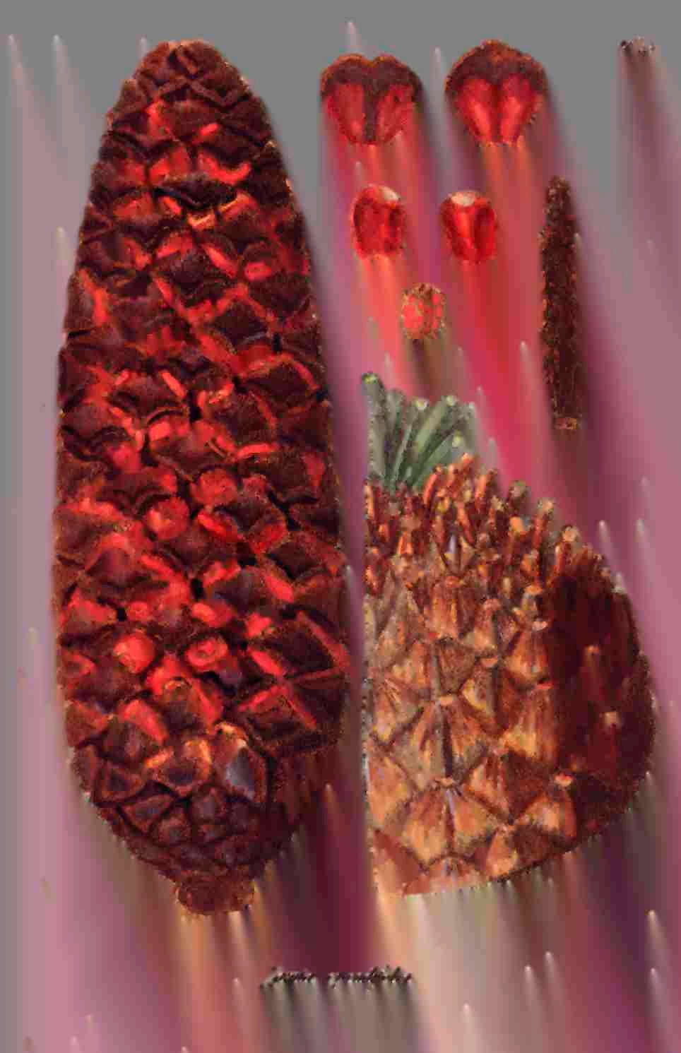

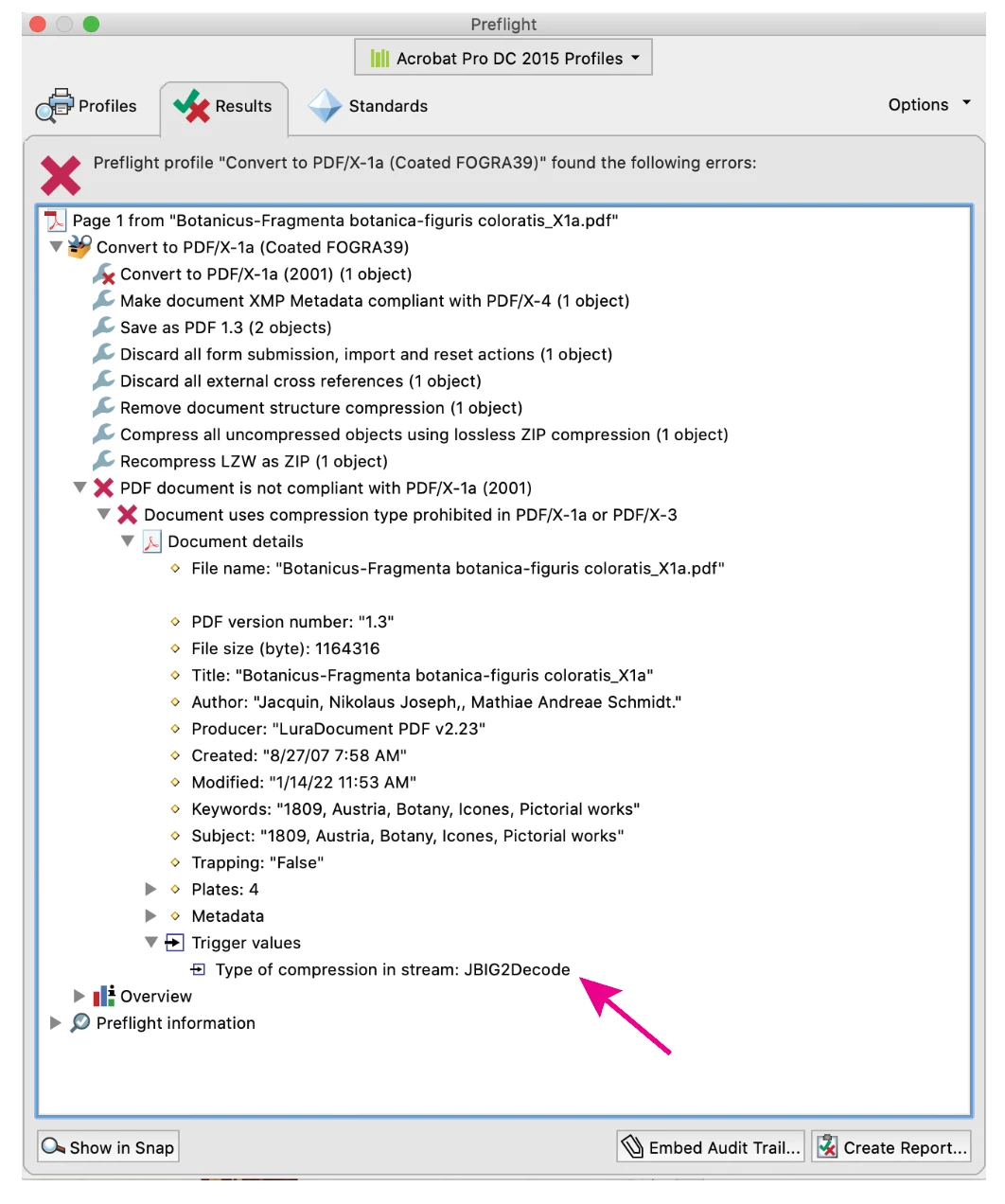

If I try to edit the image from Acrobat, using Photoshop, the smearing appears (see attached), which suggests your Acrobat install might not be the problem. The original pdf was created with a Lura Tech Scanner app (free) in 2007, which seems to be compressing the image (JBIG2Decode*) and probably causing the smearing. I briefly tried to remove the compression in Acrobat, but had no luck. Opening the PDF in Photoshop and saving as an image, or, placing into InDesign and exporting to .jpg might be the best work-around.
*as identified with an Acrobat preflight.

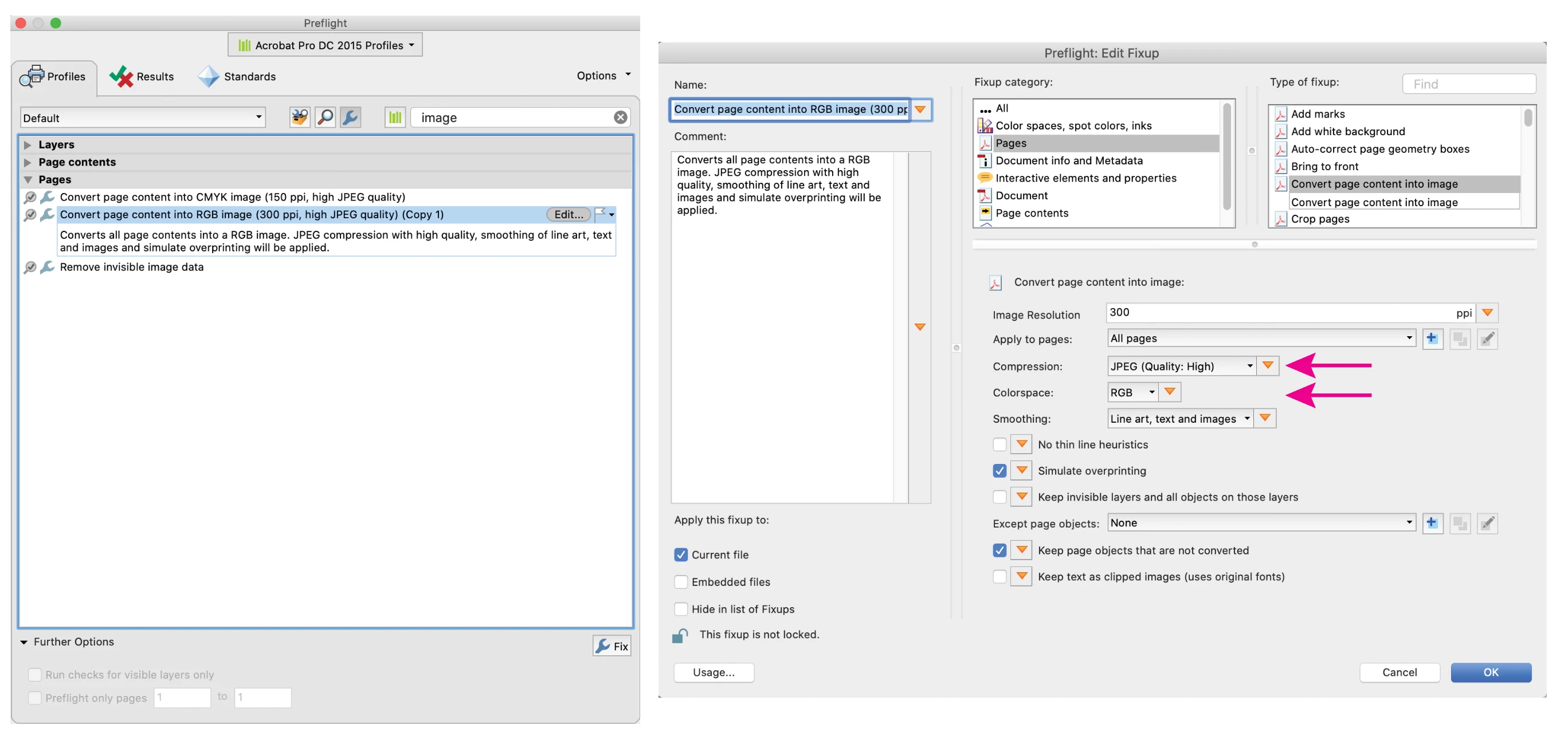

Edit, I found a preflight that will probably fix your issue, see 3rd attached screen shot. You will need to duplicate an existing preflight and change the setting to RGB (your original image is RGB). Once applied, the image opens correctly in Photoshop, it is also larger.

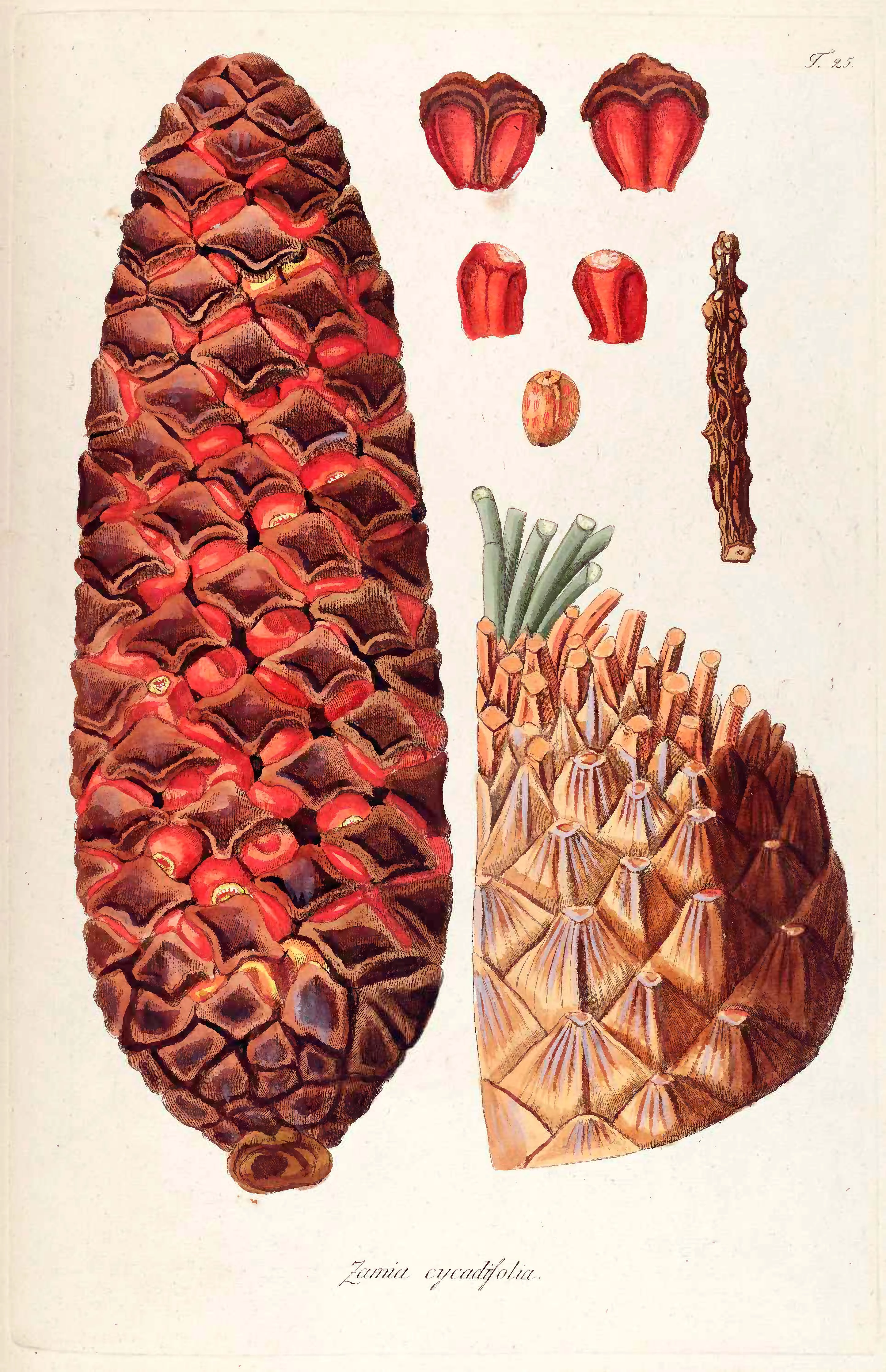

In Adobe Acrobat DC I get this:

I posted a fine JPEG.

The thumbnails are fine in Adobe, but when I look at the JPGs in their folder in File Explorer - they are smeared. They are also smeared when I open them in Photoshop 2022.
