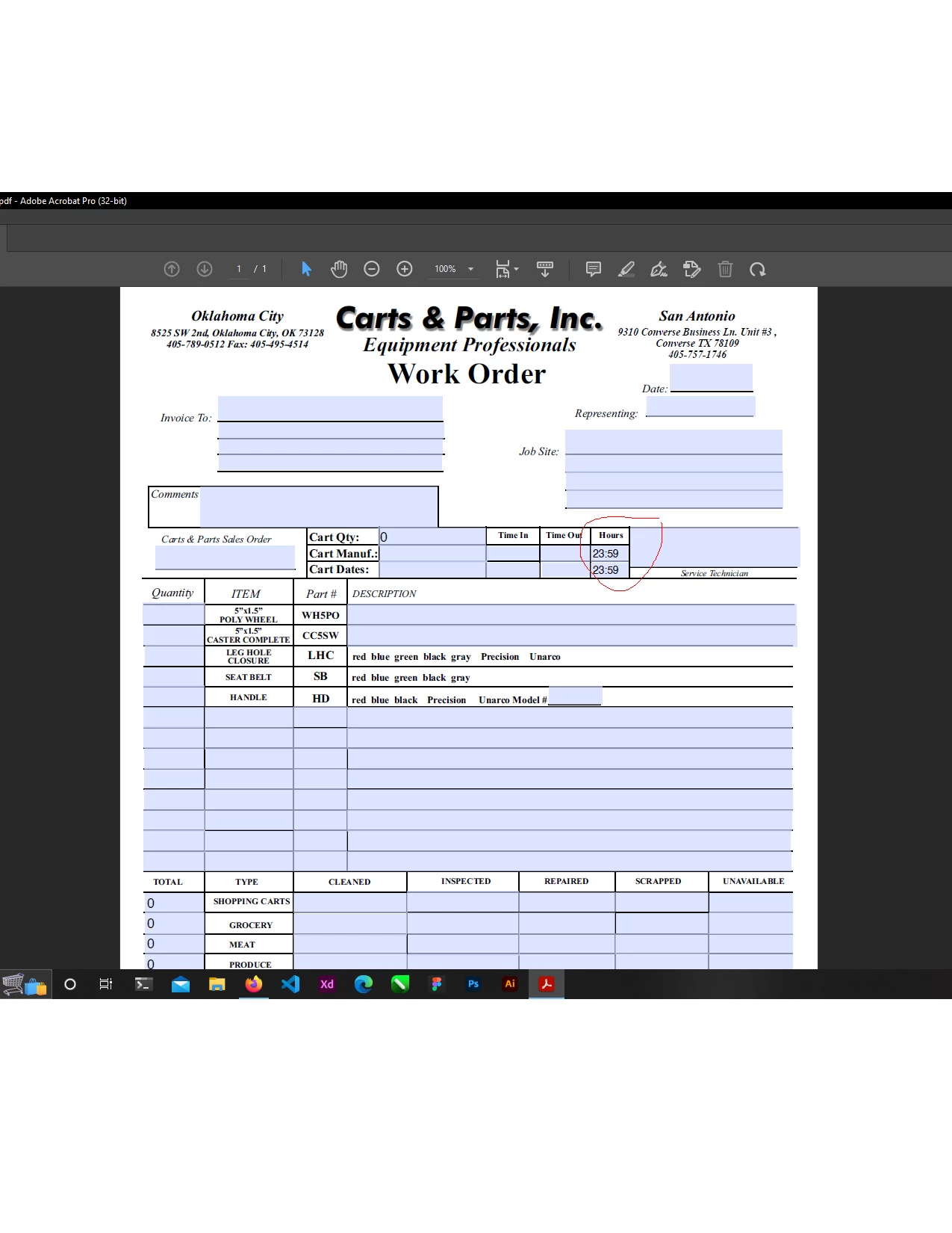

kryan74Author
October 26, 2022
Thomas
I really appreciate your repsonse and simplified code. I apologize for my novice understanding of the solution. Unfortunatly that didn't work - most likely because I didn't implement it correctly in my form. I replaced the script in the "hours" column with your code (both output boxes) and removed the formatting like you suggested. Both boxes now show "23:59" and nothing caluclates.
Can you help me implement your script with my particular form?
Thom Parker
October 26, 2022
My bad, only time2 is being used in the calculation. So it's rounding out to -1 minute
Here's the corrected code.
// Get Start and end time strings
var strTime1 = this.getField("StartTime").valueAsString;
var strTime2 = this.getField("EndTime").valueAsString;;
// add code here to check for valid time values, before proceeding.
if(strTime1 != "" || strTime2 != ""){
	// Set Calculation parameters
	var bSameDay = false;
	var strInFormat = "h:MM tt";
	var strOut = null;
	var bNeg = false;
	var strFullFormat = "dd-mm-yyyy " + strInFormat;
	// get difference in times in miliseconds.
	var nDiffMs = util.scand(strFullFormat, "31-12-1969 " + strTime2).getTime() - util.scand(strFullFormat, "31-12-1969 " + strTime1).getTime();
	if(nDiffMs < 0){
		if(bSameDay){
			bNeg = true;
			nDiffMs = Math.abs(nDiffMs);
		}else // Shift 24 hours
			nDiffMs += 86400000;
	// format time differnce.
	var dtDiff = new Date(nDiffMs + 10);
	strOut = util.printf("%02d:%02d", dtDiff.getUTCHours(), dtDiff.getUTCMinutes());
	if(bNeg) strOut = "-" + strOut;
	event.value = strOut;
}else
	event.value = "";
I've also added protection for blank inputs.   To do this right, code should also be added to test for correctly formatted input.
