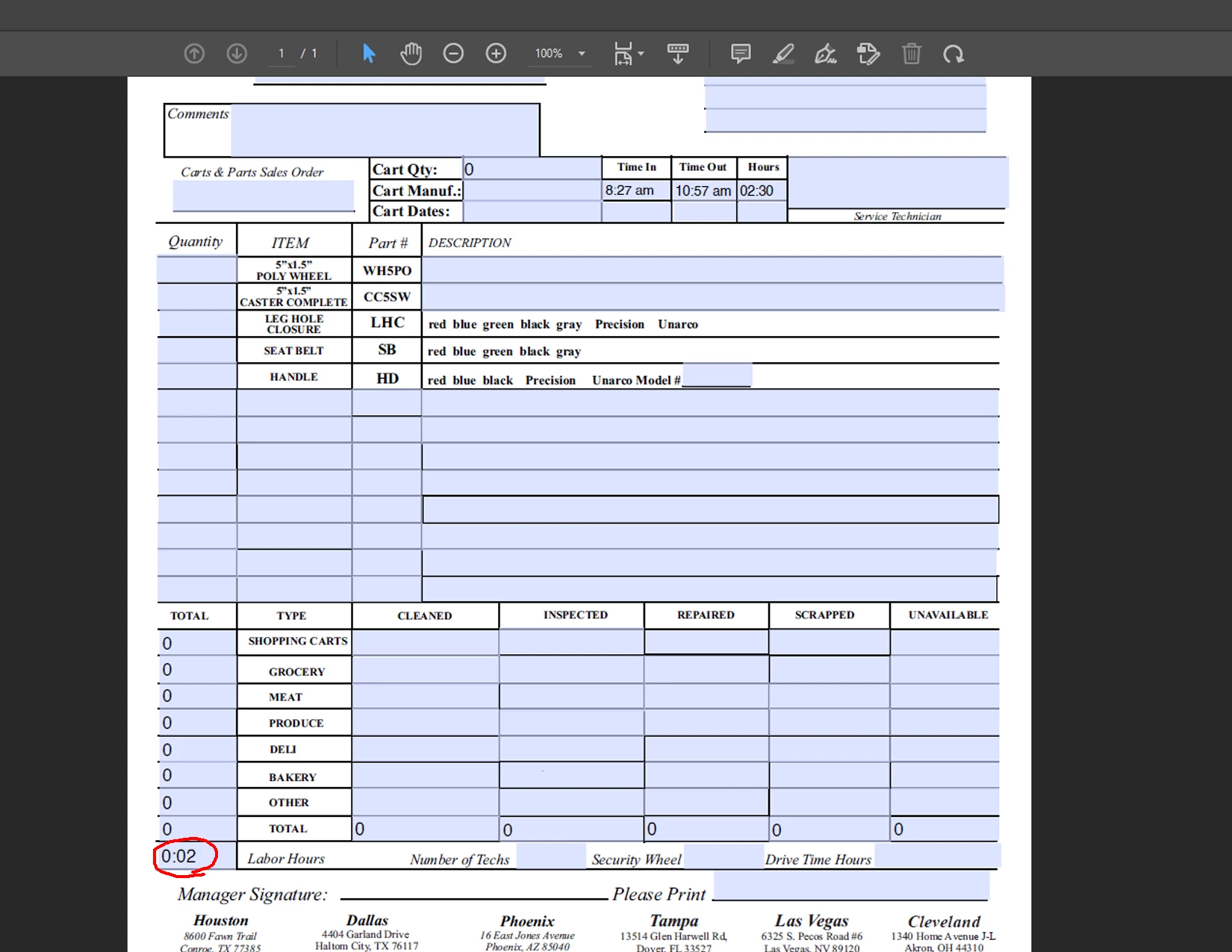

You are the man! That worked. I cannot thank you enough. Only one small bug left I was hoping you could give me the answer to
The TOTAL field at the bottom left gives me the sum of both clock in and out rows. If I add the times and tab over, it outputs correctly. If I click anywhere else in the form or tab one too many times, the output format goes awry.
The code I have in that field changes it to the correct output we need. For instance, instead of  1.50 it's 1:30 for 1 and a half hours.
// convert elapsed minutes into h:MM
event.value = (event.value < 0? "-" : "" ) + util.printf("%,101d:%,102d", Math.floor(Math.abs(event.value) / 60), Math.abs(event.value) % 60);
I'm not sure if it's the code or the way I have the cell set up. If you have time, and want to take a crack at it, it would be beyond appreciated and put an end to over a year long battle with this form!
