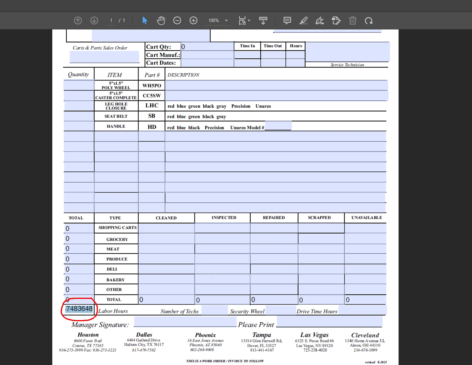

No errors in the console. The time does calculate correctly if I add times to both in-out rows. A single row still outputs random numbers in bottom total field. I did try to write a conditional statement to print a zero if the first box was empty to elimate the random numbers. I tried it both with a ternary and an if-else statement. No affect, of course, because I'm sure my syntax is off.

Thank you for this response. Believe it or not, I can follow the code you are writing. It's the syntax of the javascript that is confusing. Many of the functions I am unfamiliar with. I am used to writing React components. Thank you for being patient with me. Thankfully this TOTAL box is the only and last calculation we need done. If we need a future form, we will be looking to hire.
I removed the custom formatting of the TOTAL field and added your code to the custom calcuation section. It immediatly fills up the total field with random numbers. Nothing changes if I add times in the time-in-out rows. Would you mind taking a look?
