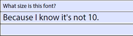

I want auto-size of text to start with chosen size.
  • December 11, 2023
  • 4 replies
  • 1357 views
I have a document where the text size in the fields is set to 10.  I want to set the text size to Auto for when data entered excedes the length of the field so that the text will shrink.  But when I set the font size to auto, it immediately makes the text size smaller than 10.  I really want to have my cake and eat it too here.  How do I set the font size to auto size from 10 on down?  This seems like it should be an easy fix, but I can't figure it out.

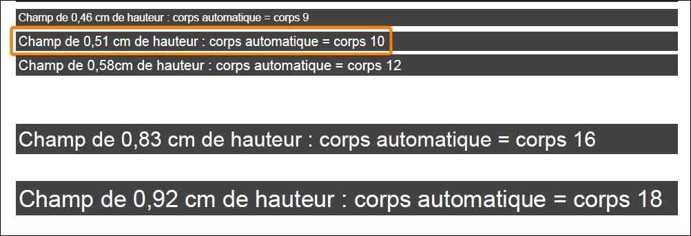

PS: these examples do not come from science or calculations, they are empirical observations made after a lot of trial and error.
JR Boulay
December 11, 2023
The initial text size depends on the height of the field.
If you want the text size to be equal to 10, the height of the field must be 0.51 cm.
If you want the text size to be equal to 12, the height of the field must be 0.58 cm.
Etc.

December 11, 2023
That's the problem I'm having.  I can set the text size to be 10.  I've done that already.  What I'm looking for is when I set the the text size to be Auto sized, I want the text to start out at 10, and get smaller only when the text length exceeds the width of the text box.  Thank you for your reply.
