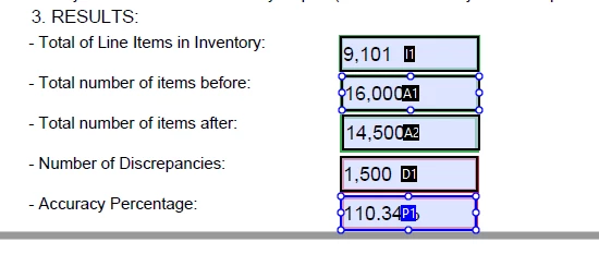

Hello I have the follwing formula that I need to add a "IF Then" statement.
event.value = Math.abs(Number(this.getField("A1").valueAsString) / Number(this.getField("A2").valueAsString));
I use it for calulating percentage accuracy.  It works find when A2 data is above A1 data.  When it is below my percentage is > 100%

Jun 24, 2024 7:38 PM UTC
Right now when A2 goes below A1 the result for P1 is greather than 100% when i need it to be 90.62%.  All my results need to be below 100%.
try67
Jun 24, 2024 10:22 PM UTC
Why that number? It doesn't make sense... You can set it as 100%, but that's not a correct result, either.
To do that latter add this to the end of your code (at your own risk):
if (event.value>1) event.value = 1;
As Nesa correctly noted, though, you have to add a condition that checks that A2 is not zero, or you'll get error messages when it is.
