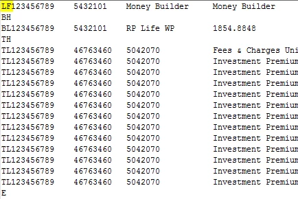

At first i thought this was related to the graphics I used within the scripts, but when i removed these, spooled and distilled the data file, I received the same error.
The error also occurs on exactly the same page during distilling, and i managed to isolate the exact record that seems to initiate the issue.  I can not see any funny characters within this record.
The data file is .txt, containing 3 main record types :
recordlayout_Clients.pdi
recordlayout_Valuations.pdi
recordlayout_Transactions.pdi
Below is the left part of a sample data file that makes up a document, if its helpful. I have isolated the issue to the header row (LF).  If i completely replace this row with the LF record from another document, it works fine.  There does not seem to be anything other than normal characters within the troublesome record.  (I even went so far as to re-type the record from scratch.  Still no joy.)

I will share 2 examples of records that cause the issue.  I tried to desensitize the data, but this removed the issue, so please treat this data with the utmost privacy.
