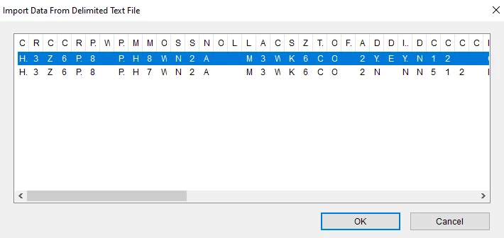

How can you create a button to do the Import Data option - i have it where i can select the .txt file but it does not give me the option when doing it manually , i am not getting the "Import Data from Delimited text file"
I have read so many posts and realize you cannot make separte forms for each line but i thought if i can have a button open this up and then just select each line for each new PDF form would work.
Correct answer Cindy31563458wshx
Either way is possible. If you want to email it to me do so via [try6767 at gmail.com].
I want to give a big THANK YOU to TRY67 - solution found.  In the form preference under "Security (Enhanced)"  under Sandbox Protections the first 2 boxes were checked "Enable Protected Mode at startup" and "Run in AppContainer". Under "Enable Enhanced Security" was also checked.  All these were unchecked and the button now works.   snapshot attached.
