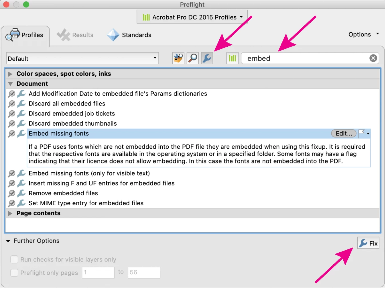

Are the fonts correctly embedded in your pdf? Go to File> Properties> Fonts, all fonts should say embedded or subset. If they need to be embedded, you can use a preflight fixup to do this, Tools> Print Production> Preflight> Fixups.

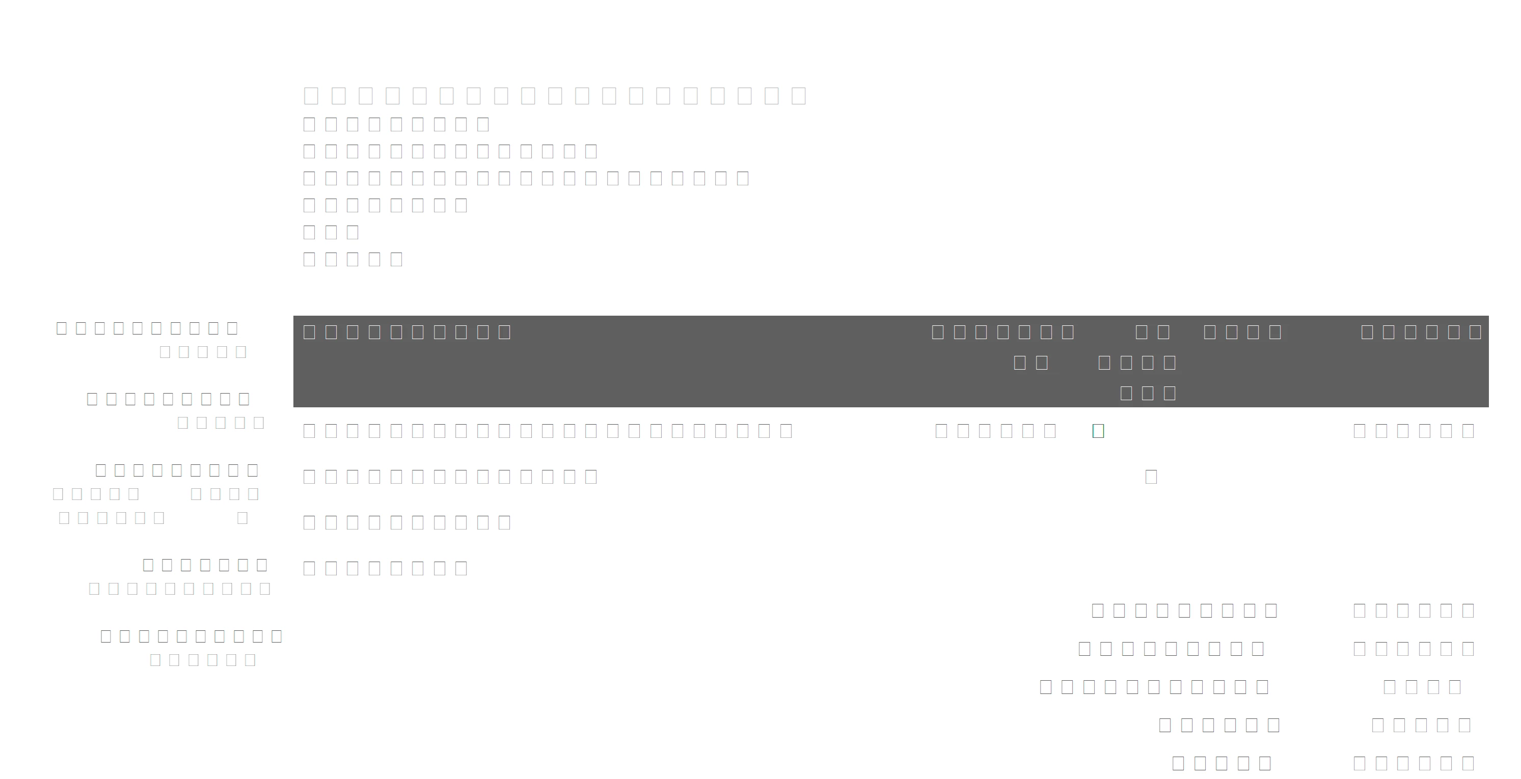

i'll try but its done that afterfix embed missing font.....
All the caracters transform in square.... and if i want to modify and add a number samec pb...
Luke Jennings3
Sep 7, 2022 11:51 PM UTC
When you run the embed font fixup, all the characters turn into boxes? that's odd.
