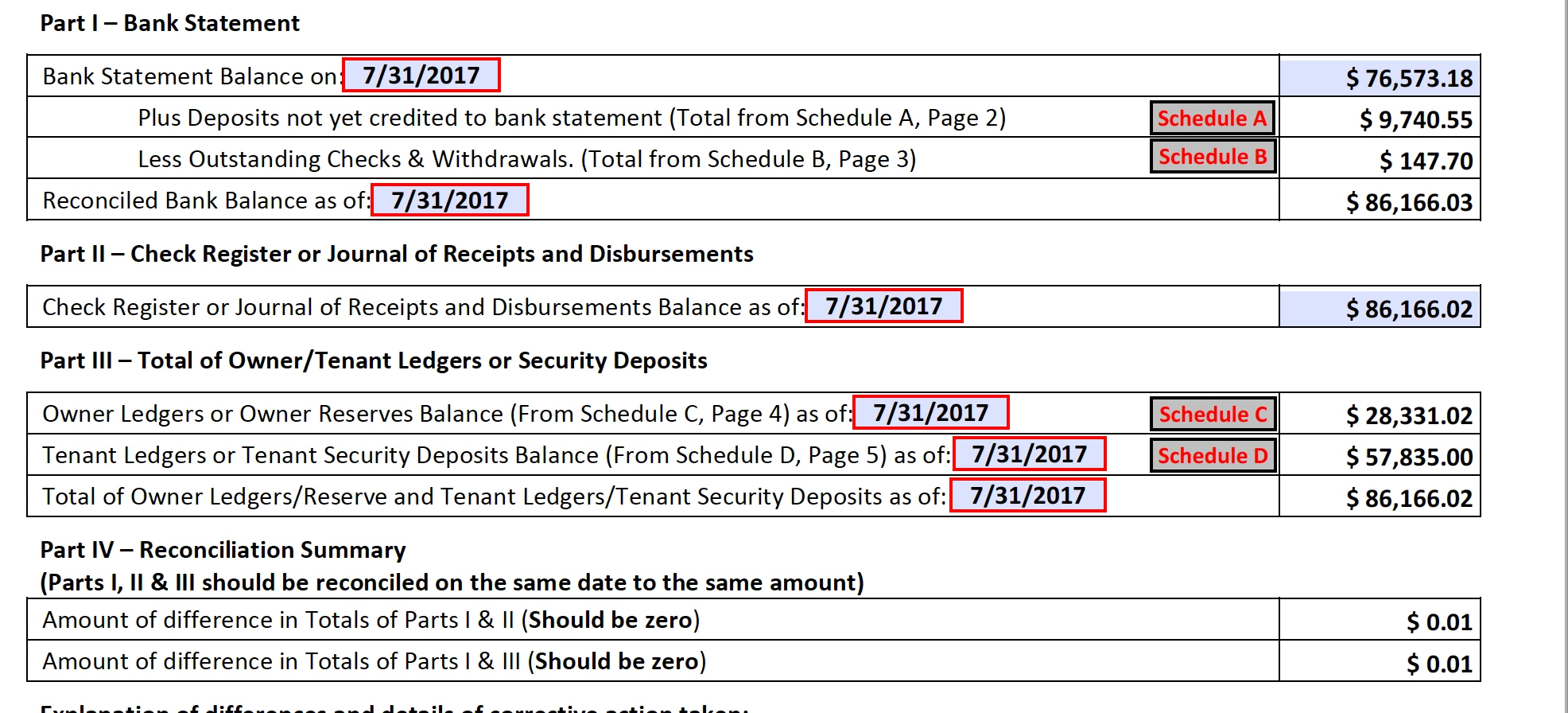

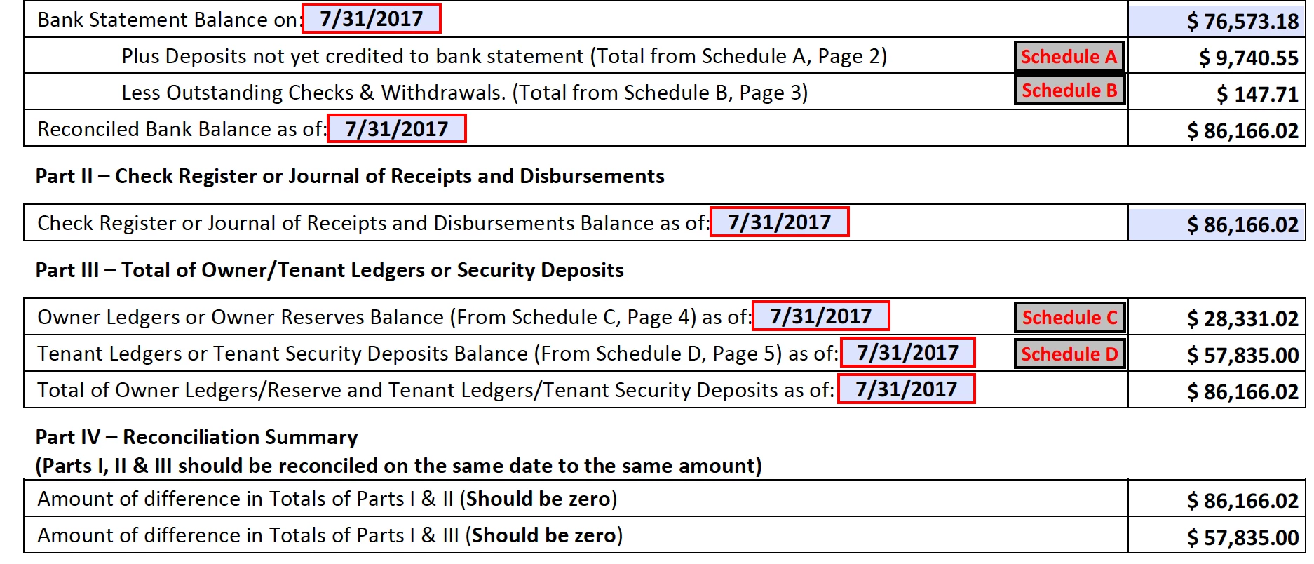

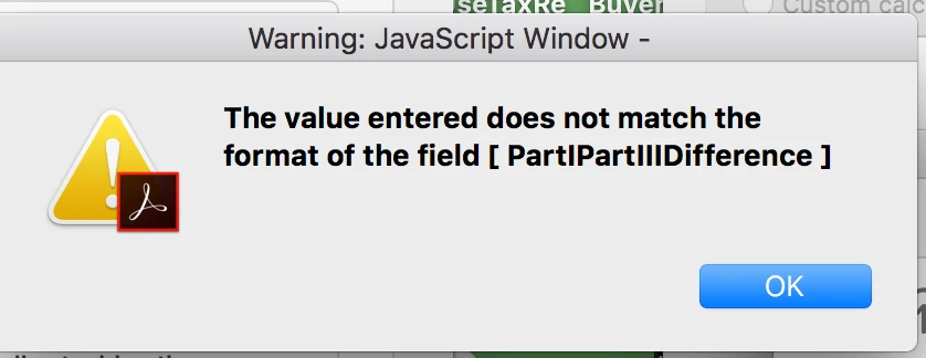

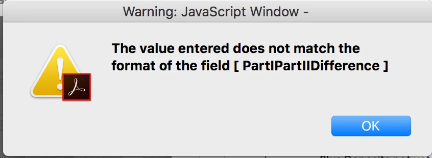

We have a form that must be downloaded from a State site.  Schedule A & B are tables that feed into this page.  But for my purposes, I just enter the amounts in the tables exactly as you see the figures.  Everything is fine until I enter the $$ in Part 2.  I have Acrobat Pro DC - so can look at the coding of the sheet by the agency.  In Part I, the reconciled Balance is defined as Part1Total.  The coding behind it is a calculation of:  BankStatementBalance+(SchATotalPage1-SchBTotalPage1).  I have entered the numbers in both of those schedules as a two digit number (exactly as you see them).  However, when I click on the reconciled Bank Balance in Part I, it shows 86166.0199999999999 as a calculation - which is why I think I'm getting the error in Exhibit B.  The format isn't a two digit number after the decimal as indicated by the formatting allowed in the form.

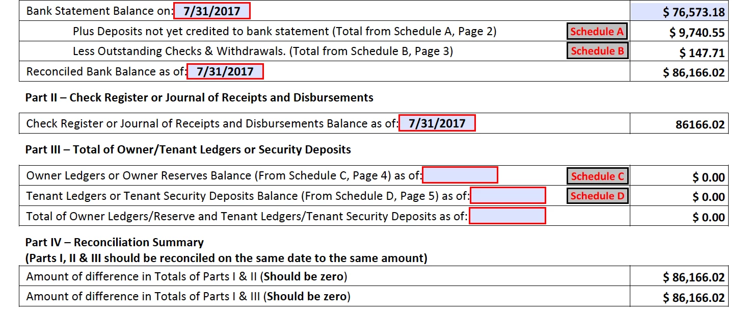

Also, once this occurs on the sheet. it will then also affect the balances in Part III.  The sheet keeps erring with the same message in Exhibit B - until I get to Schedule D.  When I enter that information, I get an error in Exhibit C - and the balances in Part IV do not update appropriately for either Section above.  See Exhibit D.

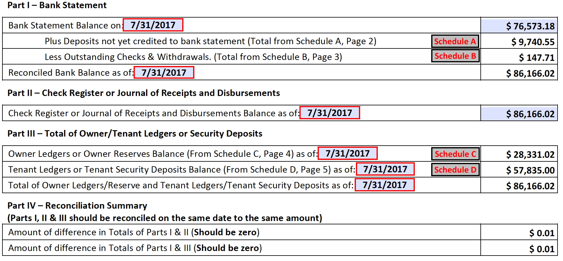

I can go into the Schedules and change them by 1 penny (Schedule B).  It modifies the Balance in the section that was changed, I receive no error, and the balance in IV is appropriate as $.01 off. (Exhibit E) If I go back up to the Schedule B and change it back, I get Exhibit B error, but it does change the Bank Balance in Section I to the correct amount, but the balance in Section IV doesn't adjust.
The kicker is that this form doesn't do this all the time.  I have a number of these that calculate appropriately.  Thinking that perhaps I had a corrupted sheet in some way, to test the sheet, I entered another month that actually balanced.  And - it balanced within this same page just fine.  ANY IDEAS ON WHAT WOULD CAUSE THIS CRAZINESS??!!  It's as frustrating as h**!

Correct answer try67
It seems to be a floating number error. You can solve it by using custom scripts for the calculations (instead of the Simple Field Notation option), and manually rounding the results to 2 digits.
For example, currently you have this as the calculation formula of "PartITotal":
The result it produces is: 72087.40999999999
If you replace it with the following code, the result will be "72087.41":
var v1 = Number(this.getField("BankStatementBalance").value);
var v2 = Number(this.getField("SchATotalPage1").value);
var v3 = Number(this.getField("SchBTotalPage1").value);
event.value = (v1+(v2-v3)).toFixed(2);
