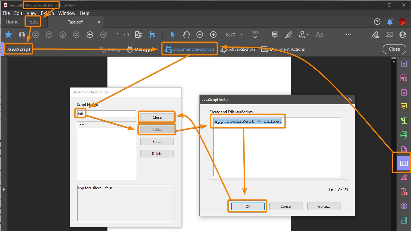

Sorry for the too terse answer but don't do that, unless you really want it to be a user choice (vs document behavior).
This script must be placed in "Document JavaScripts", name it "init" or whatever you want.
Then the script will run at each document opening (and each click on the "Close" button).
September 19, 2022

Use this JavaScript as a "Document level" script, so it will run at document opening:
app.focusRect = false;

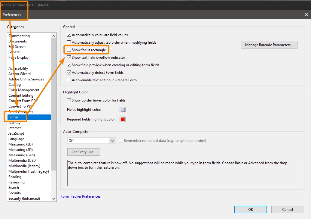

In Acrobat & Reader you can go to Preferences> Forms> Show focus rectangle (un-check), this will turn off the box for you, but not other people who view the PDF. I don't know if there is a work-around for this, although I believe buttons set to mouse enter and mouse exit do not create a black box (no clicking).

Thank you, that worked for me but I woud need the viewers to see no box too. I'll try no click as an option as well.
