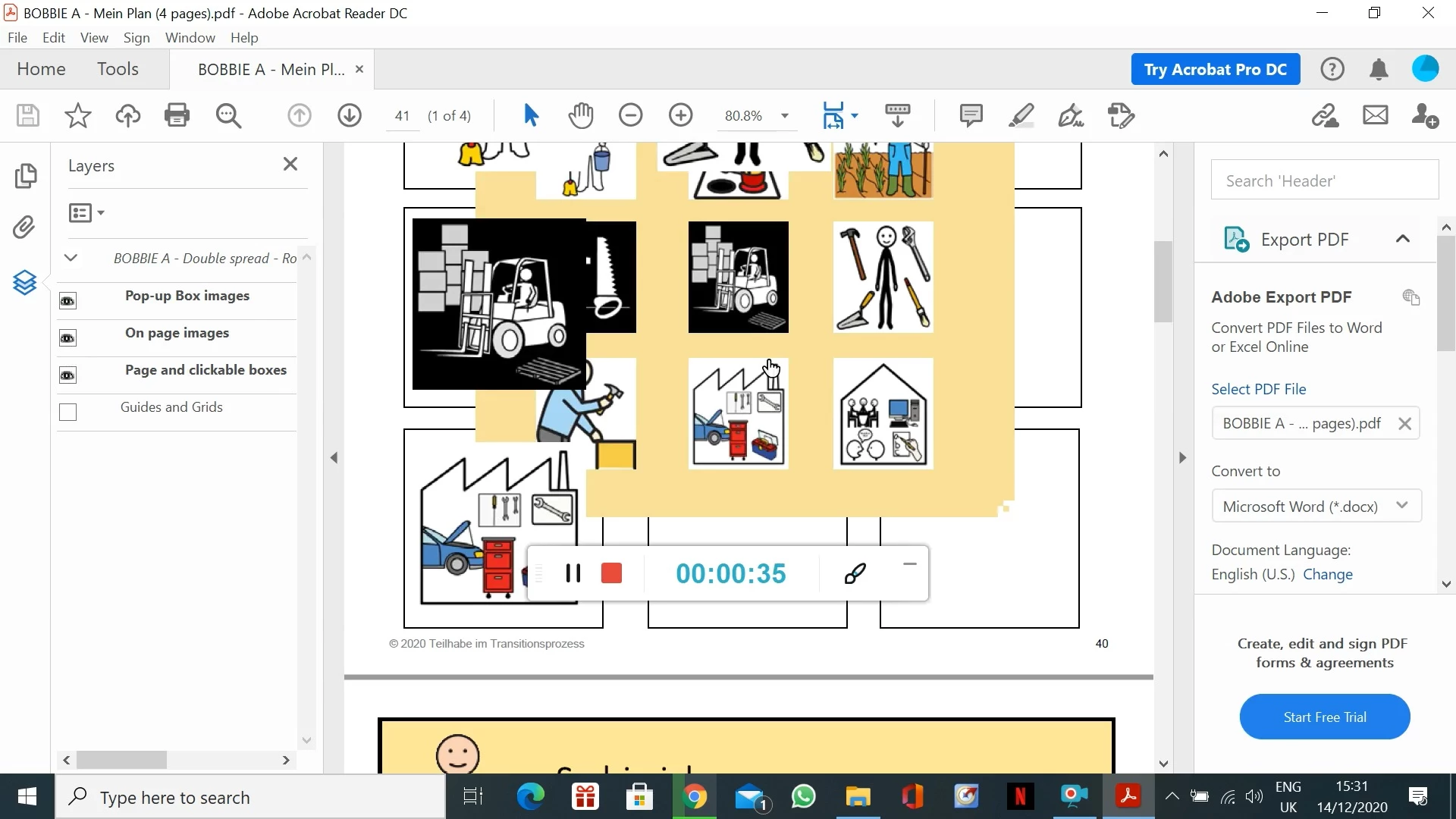

I have exported interactive PDf from InDesign. When one button is clicked, it opens a pop-up box atop, with set of buttons, out of which one is selected and then put in place of button clicked. Simple stuff!

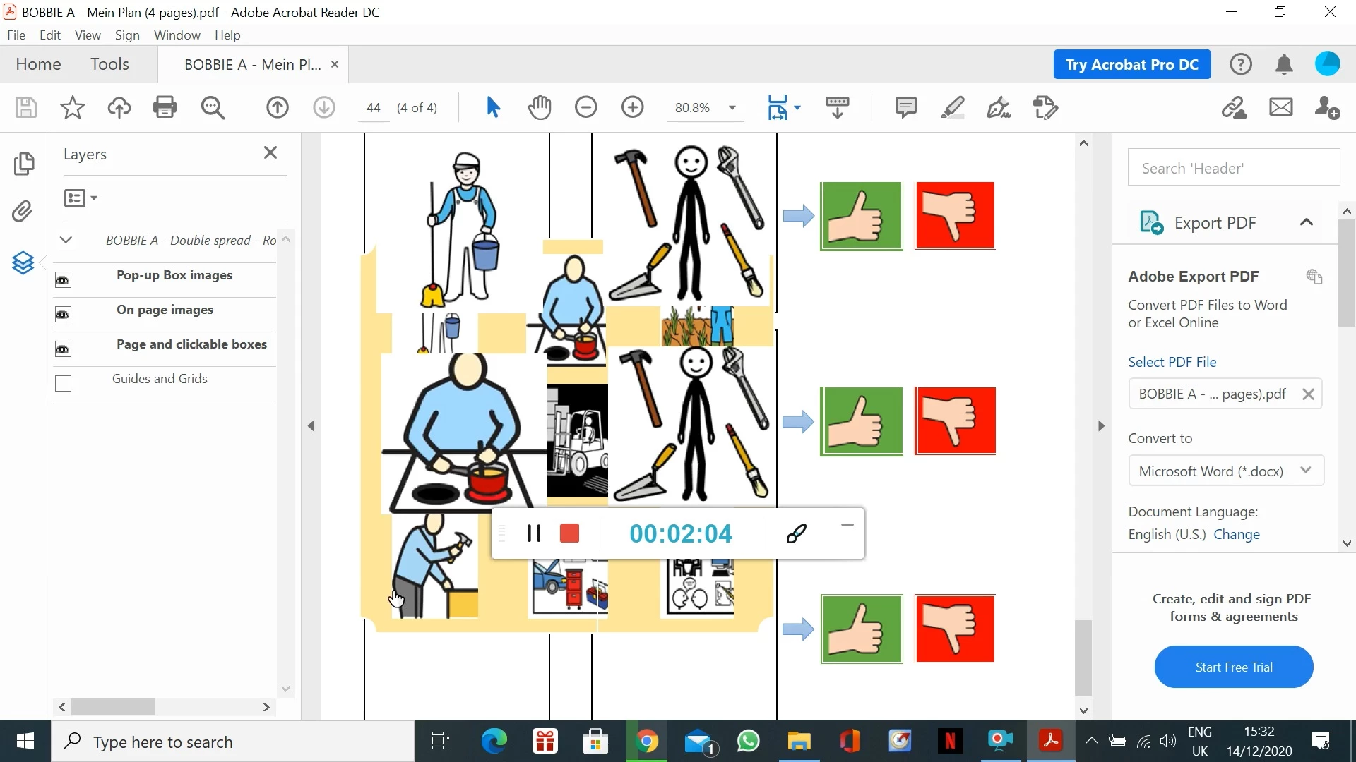

Now problem is when opening that PDF in Adobe Reader, picture from bottom of page (main button) and those from the pop-up box (on top) start to overlap; check attached pictures. In other words, Adobe Reader forgets to differentiate between layers and one has to manually go and show/hide layers, which is something my client do not want.

In an InDesign document, by nature all the elements are attached to a layer, so the form fields too (buttons or other).
In a PDF document form fields are not attached to a layer and overlap on top of all other elements, including layers.
So you have to review the design and the features of your document according to this imperative.

Due to the complexity of what you are trying to do, it would probaly be better to create the functional bit inside Acrobat, as this would enable you to use JavaScript which would give you far more control over when the buttons would be shown, it would also enable you to remove the extra pages from the document.
With the document made as it stands the only option that you really have would be to add the show/hide to ever button so that it showed the buttons you want to show/hide. as mentioned above Form fields don't really work well with layers.
