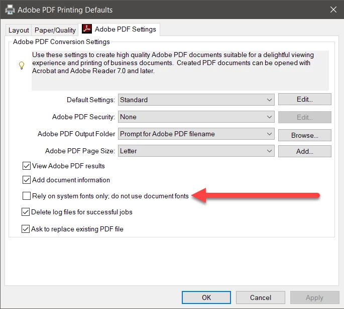

First, check the Properties settings for Adobe PDF. Go to the Advanced tab and click on Printing Defaults. Under the Adobe PDF Settings tab, look for the checkbox labelled Rely on system fonts only; do not use document fonts:
Deselect that option (i.e., no check mark), press OK, then Apply and OK. Then try the print operation again.

Thank you for this help! I only recently started having this problem, with SourceSansPro-Bold, with Outlook messages. I don't know if it started to happen because of an Outlook update or an Acrobat update, but I always keep up-to-date with both. When I first started having this error about a month ago, I went into Creative Cloud and downloaded the entire font family for Source Sans Pro (as part of my membership, under Active Fonts in the CC Desktop control panel). This didn't help. I then downloaded the Source Sans Pro fonts themselves (for Windows) and manually installed them, which finally allowed me to print my email message. Now today, the problem resurfaced, despite the entire Source Sans Pro family being Active in the CCD CP, and despite Windows having these fonts as system fonts. It took unchecking the option above to make it work. This should not have happened in the first place - it wasn't broke until about a month ago! Adobe should definitely UN-check the option above by default, or else find a solution that doesn't require doing so, seeing as these messages, for me, only came because of the Source Sans Pro font and no others.
