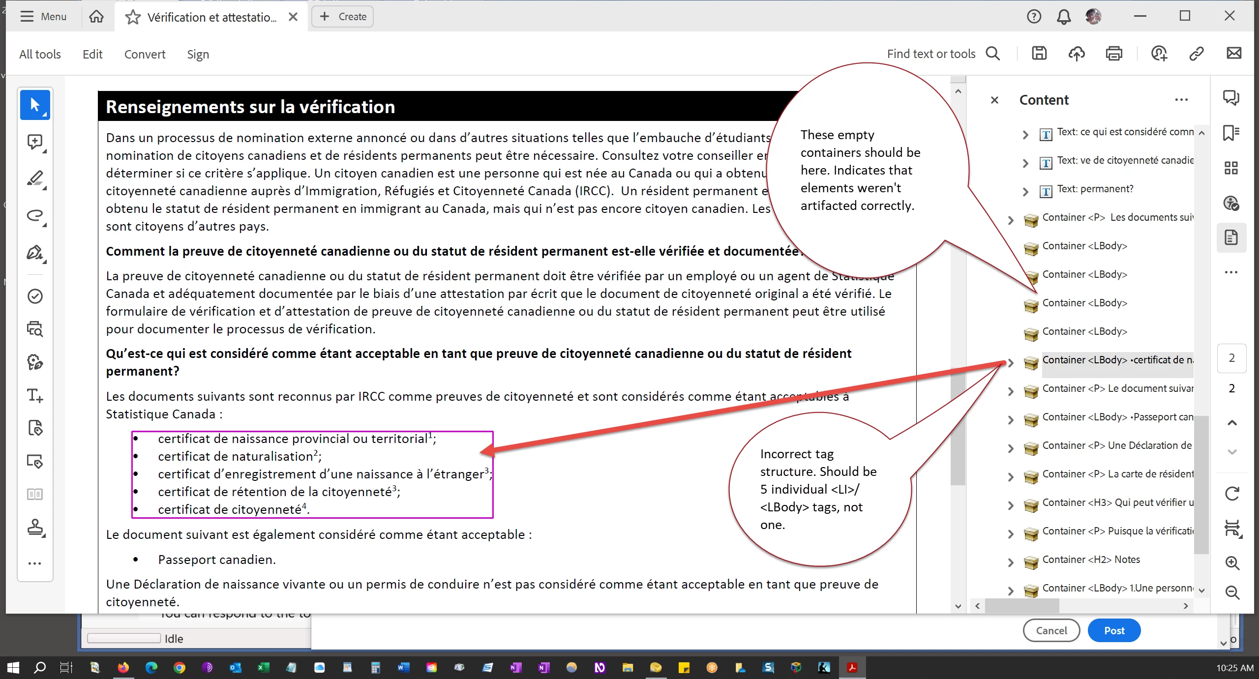

RE: the <THead> tag error, let it go for now. I tested your file on 2 Windows computers with NVDA and it didn't choke on that. But correct the bigger issue with how your office is creating the forms so that this doesn't continue to happen. It might trip up some assistive technology, other than a screen reader. Remember, accessibility is for all people with any kind of disability and using any technology.
But some serious problems lie with these issues and they should be fixed before distributing this form. They are:
1. The lists, especially the one with 5 bullets on page 2. It's voicing is: "List. 1 item. bullet certificate...territorial one. bullet certificat de naturalisation two. etc."
So there's confusion/misinformation about how long the list is and when each bulleted item is being voiced. This list must conform to:
<L> <LI> <LBody>
<LI> <LBody>
<LI> <LBody>
<LI> <LBody>
<LI> <LBody>
The tag structure in the PDF when it was exported from Word should have automatically tagged it correctly, so I don't know how it got mangled into the hot mess it is now! But add new tags and drag/drop the appropriate content into them.
