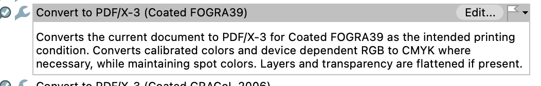

    In Acrobat preflight, it’s clearly stated that a PDF/X-3 conversion will convert colors to CMYK:
    So yes, the info is conflicting (especially since the PDF/X-3 standard itself does seem to allow RGB).
    Try PDF/X-4 (I think it should preserve RGB, not sure).
    Also, if you’re on Mac you can save PDF to generic PDF/X-3 from Preview. I doubt it converts colors to CMYK.
