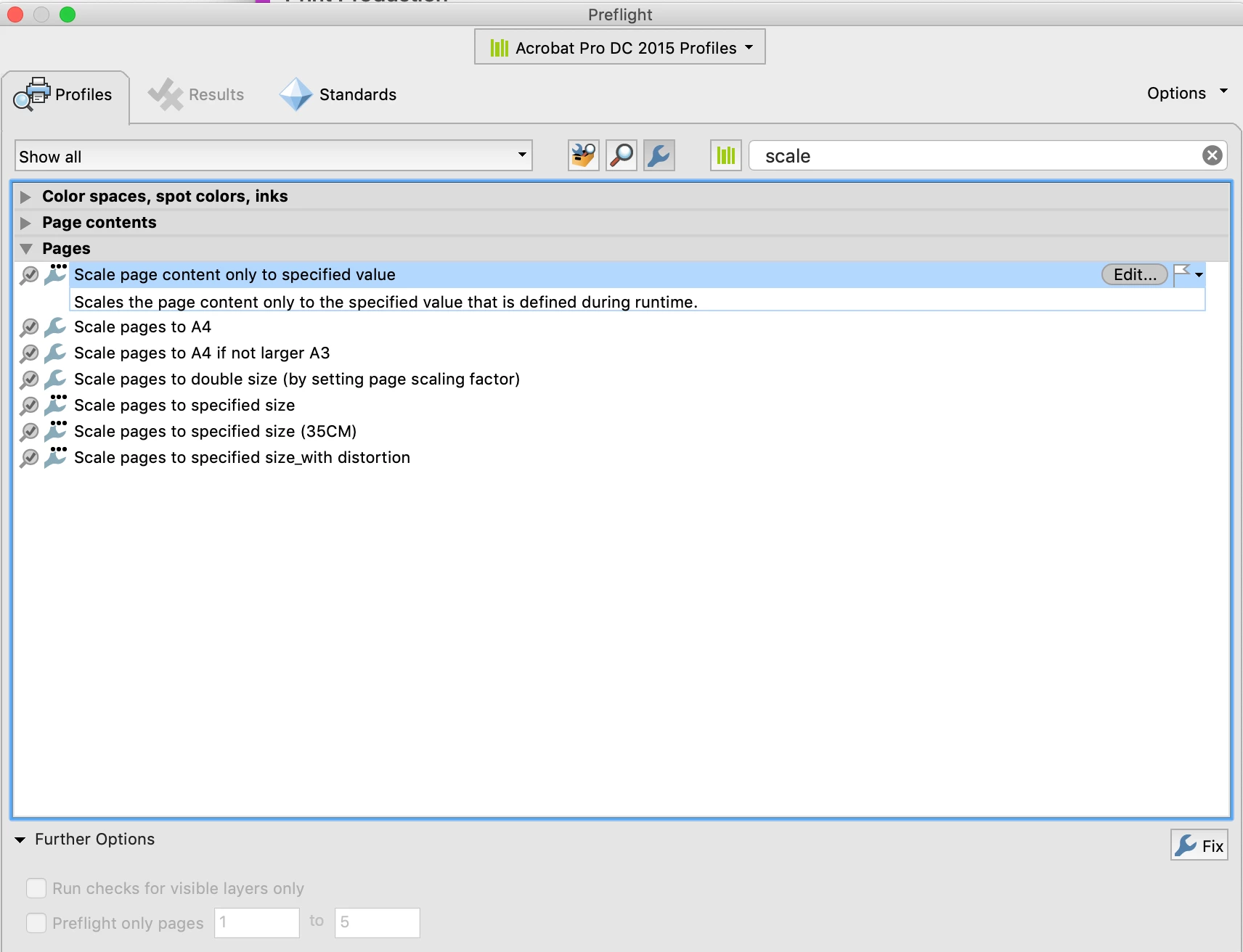

I have a copy that I am going to have printed, but was told that .185" would be trimmed off of each side. Is the a way to enlarge the page size to add a white boarder around every page? I know in Photoshop, you can enlarge the image size and/or canvas size, so I know I could do it in Photoshop, but it would have to be done page at a time, 250 pages!!!!  Is there a way to do the same in Acrobat? I don't want anything cut off by mistake when printed.

So you have a document (let's say it's 8.5 x 11") and you are concerned something will get cut-off when printed, normally, an 8.5 x 11" page would include bleed and be printed on a larger sheet, then trimmed to the final size after printing. You would supply your printer with a PDF that has an overall size that is larger than 8.5 x 11, (with or without crop marks) but with a trim size of 8.5 x 11, this would be created from the original program (InDesign for example). If you have an 8.5 x 11" PDF without bleed and with content that ends at the trim line (no margins), your best option is to get a new PDF with proper bleed and margins, if this is not possible, you have a few options;
1. You can reduce your page content size (to about 95%) and add a white border, you can do this using an Acrobat Preflight Fixup (Tools> Print Production> Preflight> Fixups) see attached screen shot.
