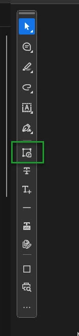

We figured out a work around. Well it use to be we could add the text using the "T" in the tool bar. There is another icon, I'm not sure if it's new or not. It is a box with a comment bubble. It allows you to add text anywhere regardless of the text boxes. We started using that icon and we no longer have issues.
Jan 13, 2025 8:44 PM UTC
Hello!  This is the OP, I was excited to see your reply.  I just tested it.  It is called "Add Text Comment" and when I tried it at first, it had a red border and green text.  I changed the properties to remove the border and change the text to black and then clicked the option to make the current properties the default, so I don't have to do it every time.  I also tested to make sure it prints with that comment, and it does!  This is a great work around, much easier to move around and deal with.  There are two small drawbacks: 1.  when you have the text comment selected, the tool is very sensitive and every click of the mouse adds a new box and 2. the box writes over the existing text, so it might block out the line you're adding text to or block out surrounding text, so that might be an issue.
