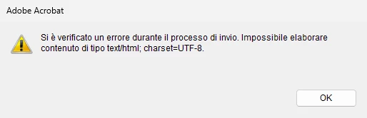

For anyone interested, here are the results of 5 isolated tests I performed in Acrobat Reader using 5 different methods to ping an endpoint:
Tested methods:
01 – Net.HTTP
02 – submitForm
03 – app.launchURL
04 – doc.getURL
05 – SOAP.request
Results summary (from Reader):
Method Ping Sent ! Browser Page Opened ! Acrobat Page Opened
01 – Net.HTTP❌❌❌
02 – submitForm✅❌❌
03 – launchURL✅✅❌
04 – getURL✅✅❌
05 – SOAP❌❌❌
Conclusion:
For the purpose of this thread (a truly silent ping from Reader), scenario 02 (submitForm) would be ideal — if it weren’t for the system alert (here attacched) that appears when the request is completed. The ping is sent, no page is opened, but a modal system message still interrupts the user.
If anyone finds a way to suppress or avoid that system alert, that would be the holy grail. 🙏
Thom Parker
April 18, 2025
I applaude your efforts in testing the limits of internet operations from a PDF, but suppressing security messages to the user from an operation on an untrusted radom PDF, would probably be an Acrobat Security violation.
Thom Parker - Software Developer at PDFScriptingUse the Acrobat JavaScript Reference early and often
