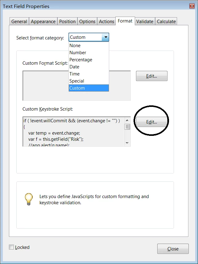

I have worked it out thanks. It was "radiobutton". But also needed to add script into the area below:
Open you pdf file, get into the "Prepare Form", right click on the "total Score" text field,  open the "Properties...", then like this picture,click the "Edit...", and input the script below.
if ( !event.willCommit && (event.change != "") )
    var temp = event.change;
    var f = this.getField("Risk");
    //app.alert(g.name);
    if (temp>=5 && temp <=24){
        var g = this.getField(f.name+".0");
        g.defaultIsChecked(0,true);
    if (temp>=25 && temp <=39){
        var g = this.getField(f.name+".1");
    if (temp>=40 && temp <=54){
        var g = this.getField(f.name+".2");
    if (temp>=55 && temp <=64){
        var g = this.getField(f.name+".3");
    if (temp>=65 && temp <=75){
        var g = this.getField(f.name+".4");
    this.resetForm(["Risk"]);
