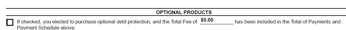

I'm using a product that pulls field data in from XML when processing PDF documents for a loan origination system.  I have some code that I am trying to use to hide a particular field when our loan origination system passes the value "$0.00".  I also have some code that I am trying to hide a date field next to a co-borrower 1 and co-borrower 2 fields.
When processing the PDF's through our system they look correct on screen.  If there isn't a co-borrower 1, there is not a date in the date field next to the name.  Same deal with co-borrower 2 and its date field.  When there is no loan insurance, the field is hidden.  When there is loan insurance, the amount is in the proper field (example $917.17).
However when we go to print the flattened PDF's when processing is completed, no matter what we see a value in the loan insurance field, even if it is $0.00.  Also we see the date next to each co-borrower's name.
Why doesn't the javascript code to hide a field work when printed?  Why is it only working when on screen?  This should be a simple fix.  Our product vendor wants to bill us to correct this.  Surely I am VERY close to fixing this without involving "professional support"?

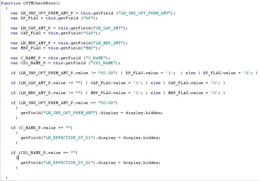

The code is as follows
var LN_INS_OPT_PREM_AMT_P = this.getField ("LN_INS_OPT_PREM_AMT");
var C_NAME_P = this.getField ("C_NAME");
var CS1_NAME_P = this.getField ("CS1_NAME");
   if (LN_INS_OPT_PREM_AMT_P.value == "$0.00")
        getField("LN_INS_OPT_PREM_AMT").display = display.hidden;
    if (C_NAME_P.value == "")
        getField("LN_EFFECTIVE_DT_D1").display = display.hidden;
    if (CS1_NAME_P.value == "")
        getField("LN_EFFECTIVE_DT_D2").display = display.hidden;

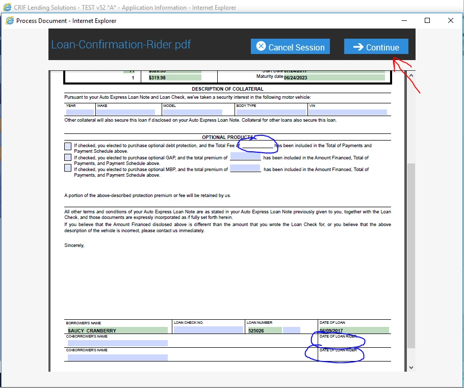

Images:  When Processing note the fields are correctly hidden.

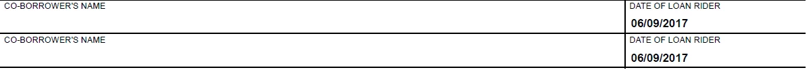

After processing when you go to print the flattened PDF's, the hidden fields are revealed.

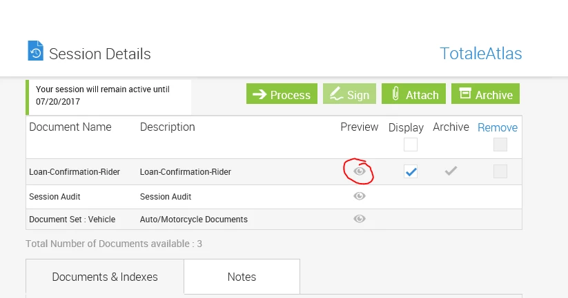

The printing is after the documents are processed.  There is a small eye icon and when its clicked on, the PDF loads in a window that uses Adobe inside the frame in Internet Explorer.
During processing fields are not always locked, and they behave as one expects. Once you hit continue, the software loads the next form.  Once you complete all of the forms you are at the end where you can preview them to print.  What is printed is viewed by  QC and they can flag it to go into a document imaging system.  It's quite the elaborate process, and I'm trying to figure out what's at fault here. My code, Adobe, the vendors code, etc...  I'm coming here first because its standard JavaScript and its Adobe PDF... plus they want to charge.
I'll try to document the process in screen shots below...
In our system you generate documents.  This displays a list of all forms in a document set.  You hit process and a new window appears and you go through in order.  During this "processing" phase, on screen everything is executed perfectly.  Correct fields are hidden in this example circled in blue.  You would click the continue button to advance to the next form if there is one.
When you are done processing all of your forms you would want to view them.  You can view them individually by clicking the grey eye icon I have cirled in red below.  Or the very bottom Document Set would merge all of them in order from top to bottom.  This is a very simple document set below.  Once the document signing is complete the people who signed may want a printed copy so you would click the eye and then once the PDF opens you would click print.  Also however it looks in this preview is how it will be sent over to document imaging system where it is properly indexed for future retrieval.

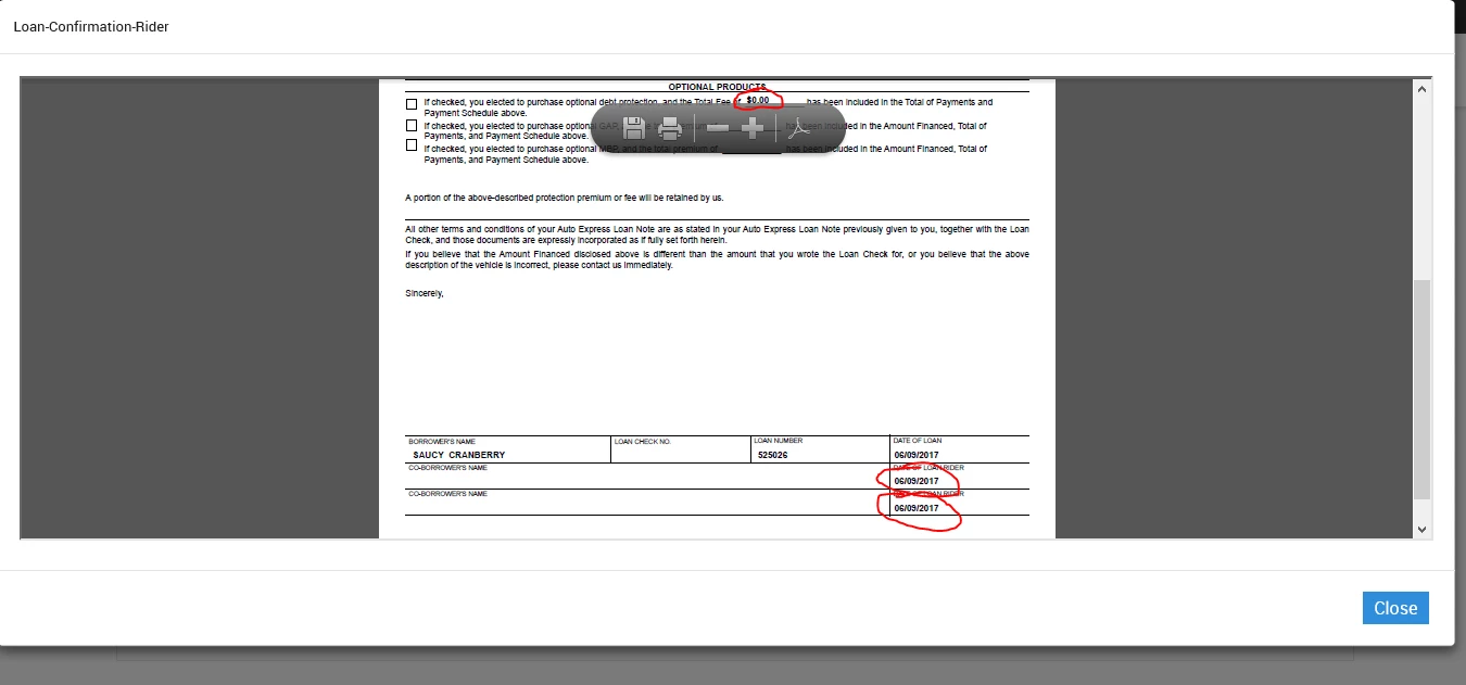

This is what you get when you do preview.  It prints exactly how it previews.  Note for some strange reason the circled fields are no longer hidden.  This is the problem I am trying to overcome using JavaScript.
I hope it helps illustrate the flow.  I know this is a unique situation but it still uses Adobe PDF Reader and PDF technology, so I wanted to see if there are any PDF experts out there in advanced PDF scripting that may have any idea.  I'm not sure why fields hide in the initial processing, but then once its flattened they are no longer hidden.

This happens immediately.  It looks perfect on screen but once you print it, the hidden fields are no longer hidden.
The javascript is at the end of the code which was written using Autonomy Forms Designer 7.5.2.  Its a Liquid Office Product, now owned by HP.
The third party software that does the processing and flattening of the documents is web based.  Our loan origination system pushes XML data to them via what I think is a SOAP call or something to that nature.  The third party software uses this information in the XML to determine which documents to pull in depending on what type of loan product it is.  Based on the XFM documents done in Autonomy Forms Designer (exported as Fill and Print PDFs), Javascript can be used to do all sorts of things, like group checkboxes, make things manditory, mask fields (like SSN for example), check things off if something else is filled out.... you name it.  If it can be done in Javascript it can be done.
The third party software does the processing and the end users sees the form through Adobe Reader iview in Internet Explorer.  Adobe Reader is in a frame which is wrapped in this third party applications UI.  In the top is a continue or cancel session, so as you click continue it loads the next document and so forth, until all documents are reviewed and signed.  Signing can be done via Topaz signature pad, or it can be sent out via Adobe Echosign for electronic remote signature capture.
Maybe I would need to share the form, but let me get authorization to do so, or maybe sanitize it for public internet consumption.  I can tell you the code in the file is what I pasted above, however there is a little more to it that checks (or doesn't check) boxes next to three different fields (dept protection/insurance, GAP insurance, MBP - Mechanical Breakdown Protection / Auto warranty program).
The function is called with no arguments and here is a screen shot of the full function..
