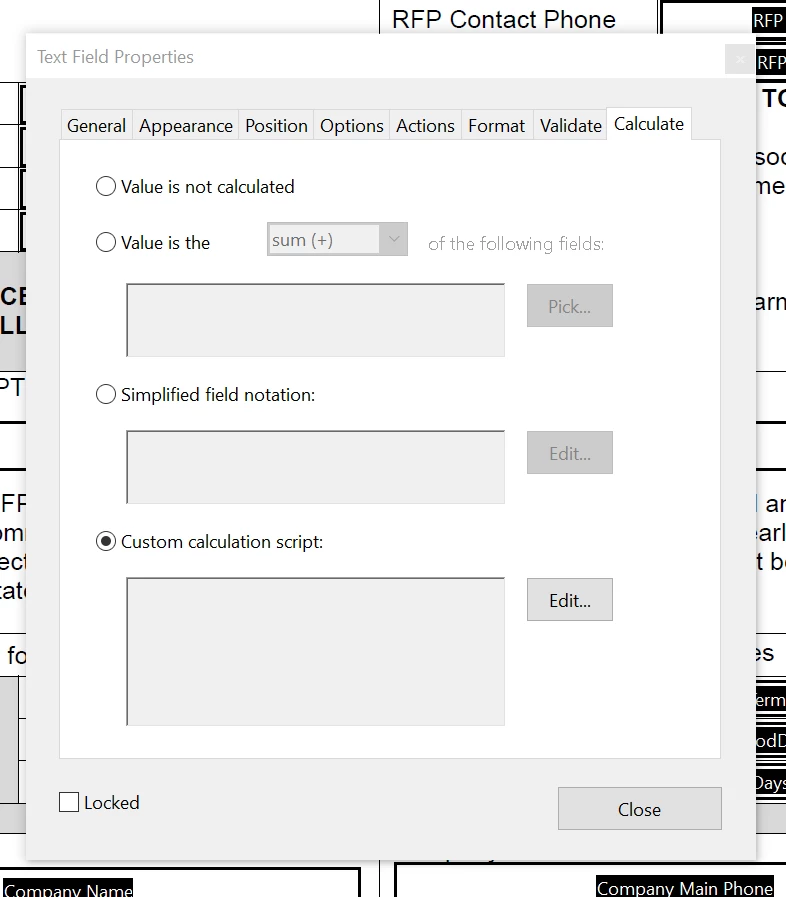

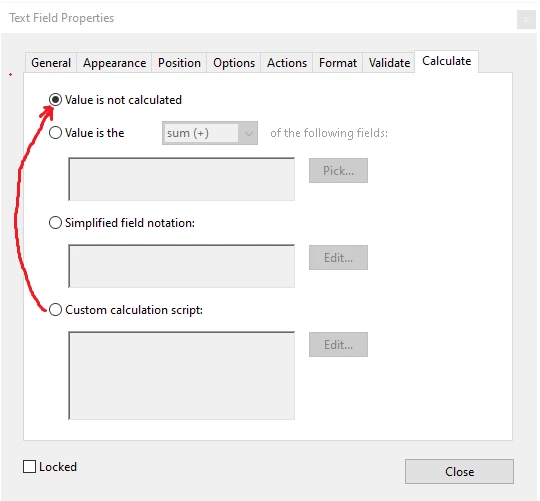

I am trying to use custom calculation script using javascript to populate a field on the PDF. I select "Custom calculation script", then press the "Edit" button, enter the code below into the editor, then click the "OK" button.  The problem is that the code is never retained and the radio button is reset to "Value is not calculated" on the fields "Calculate" tab.

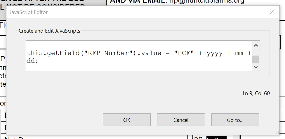

I'm not sure how to describe this. My original code as shown did not get an error after pressing OK in the editor. I tried your code as well, no errors after pressing OK, but code is not retained. See the pics below.
Step 1: Select "Custom calculation script" and click the "Edit" button.
Step 2: Add code and click the OK button.
Step 3: The result after pressing OK
