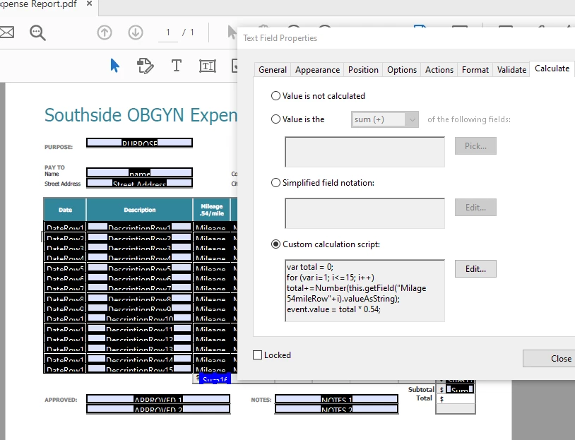

I am creating a fillable PDF in Adobe Acrobat PRO DC. I am needing to calculate one column so that everything in the 15 rows(milage 54milerow1, milage 54milerow2, milage 54milerow3, etc) is multiplied by .54 and then totaled at the bottom in Sum16... Can someone help me with this?

You can use this code as the custom calculation script of Sum16:
var total = 0;
for (var i=1; i<=15; i++) total+=Number(this.getField("Milage 54mileRow"+i).valueAsString);
event.value = total * 0.54;

Thank you! Is there anything I need to change/add in this? Or should I be able to just copy and paste? I went into the properties of Sum16, went to calculate and pasted the code under custom calculation script but it's not doing anything.

You don't need to change anything. However, you do need to change the value of one of the fields for it to "kick in".

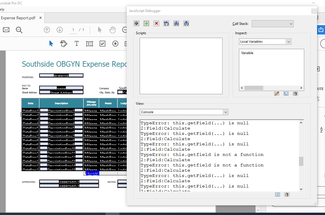

If it's still not working press Ctrl+J and check if there are any error messages in the window that opens.

This is what I am getting back.
