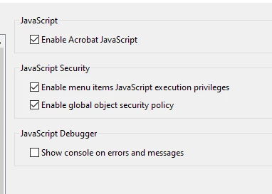

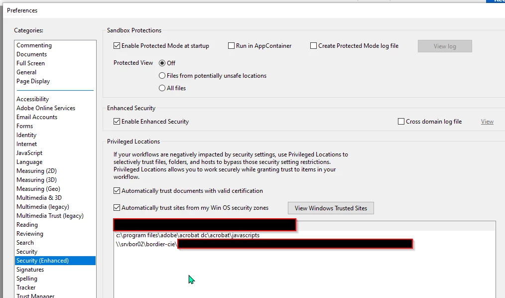

What security options have you tried?
Thom Parker - Software Developer at PDFScriptingUse the Acrobat JavaScript Reference early and often

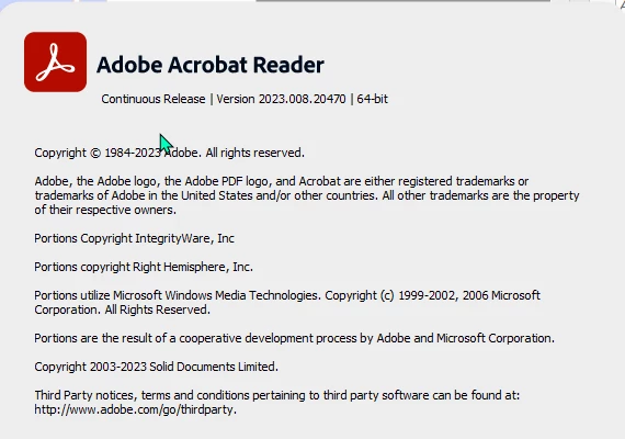

The application is Adobe Acrobat Reader (see details attached)

This will only work in Acrobat. Reader can't attach files like this, only as an annotation.
