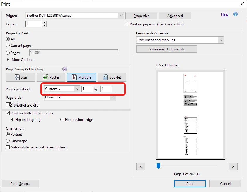

Not quite sure that's what you mean, but in the Print dialog you can specify the page to print 1x4 to get four original pages onto one physical one, for example:
The pages will be automatically scaled to fit the paper you're printing them to.

Thank you! Thank you! Thank you! I don't know how but I completely missed that in the settings! When I tried, it was printing tiles of pages. Because I tried 2x4, 3x4 but never tried 1x4.
Now,
This solves part of my problem. If I take 1x4 for the entire document, in some output pages some parts are scaled down to fit the page. I dont want that. In my case, it is not 1x4 throughout the entire document. It is like 1x4 in the first page, 1x3 the next page...and so on.
