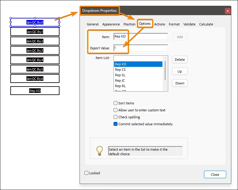

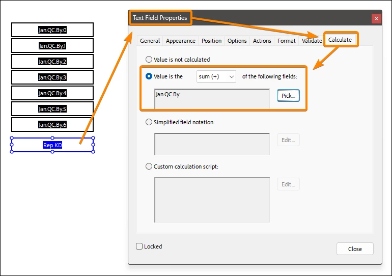

JR Boulay
October 30, 2025
You don't need a script to do this.
Add ‘1’ as the export value to each relevant menu item, and then ask the text field to add up the relevant fields.
Using the form field naming convention, to calculate the sum you can simply designate the (virtual) parent field in the list of fields to be added, which is faster and more flexible (it allows you to add/remove fields without having to modify the calculation).
See attachment.
PDF Automation Station
October 30, 2025
They are adding up 7 different names across 72 dropdowns.  If you put all the export values as 1 the total will be all dropdowns that have a value, not the number of dropdowns with a specific value.
