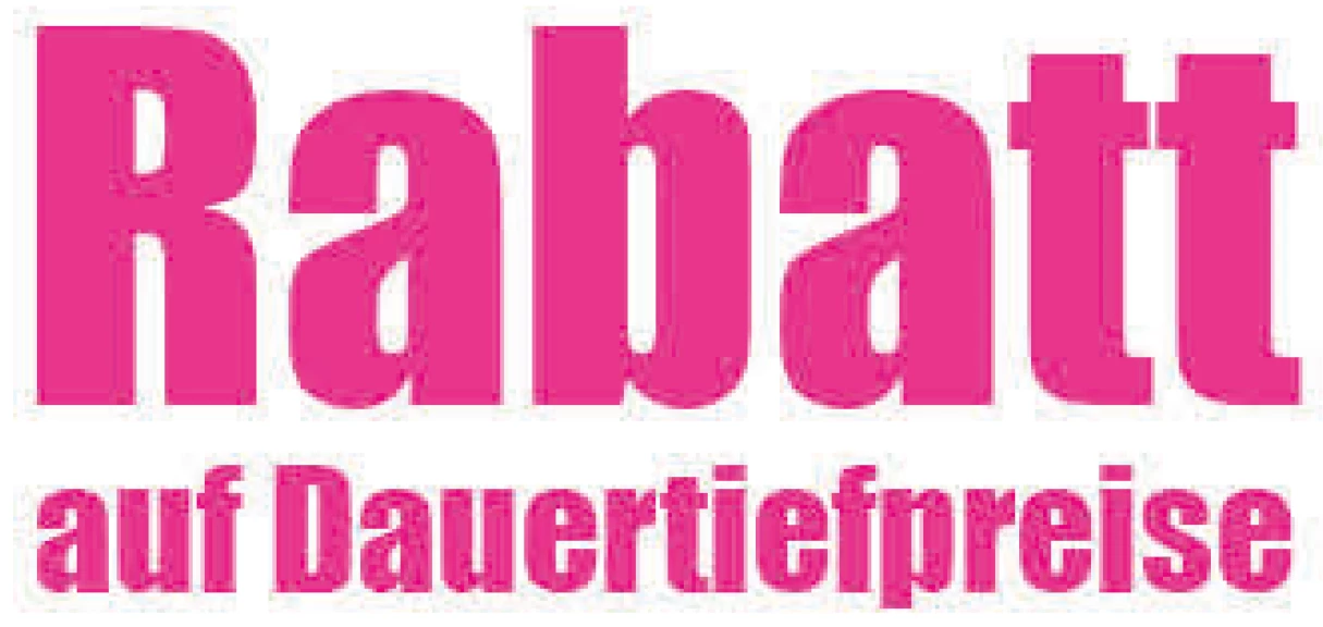

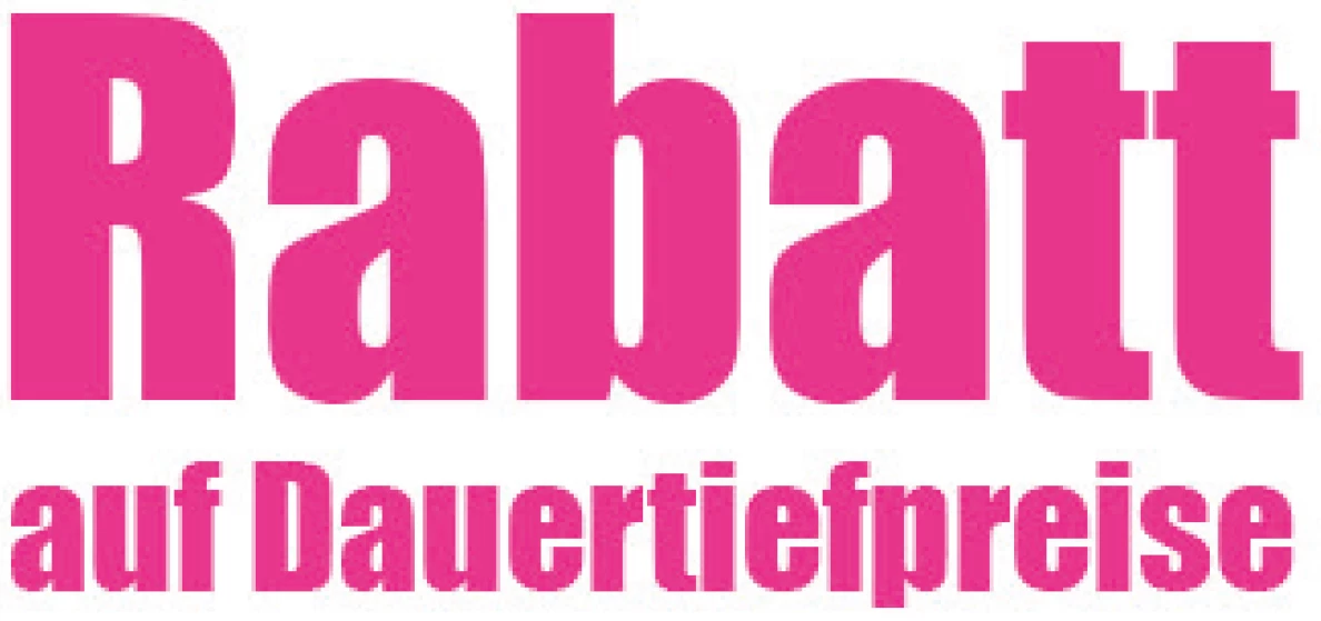

Hi
Why do the jpg-artifacts increase when I make a color conversion? They do increase independent on the rendering intent. Does Acrobat make a recompression in the background?
image before conversion
image after conversion
