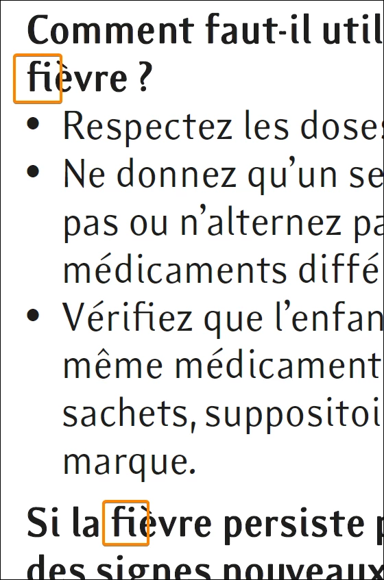

Peut être, mais dans ce cas pourquoi est-ce que ça ne concerne que le glyphe "fi" et pas les autres caractères ?
La copie:
Le collage:

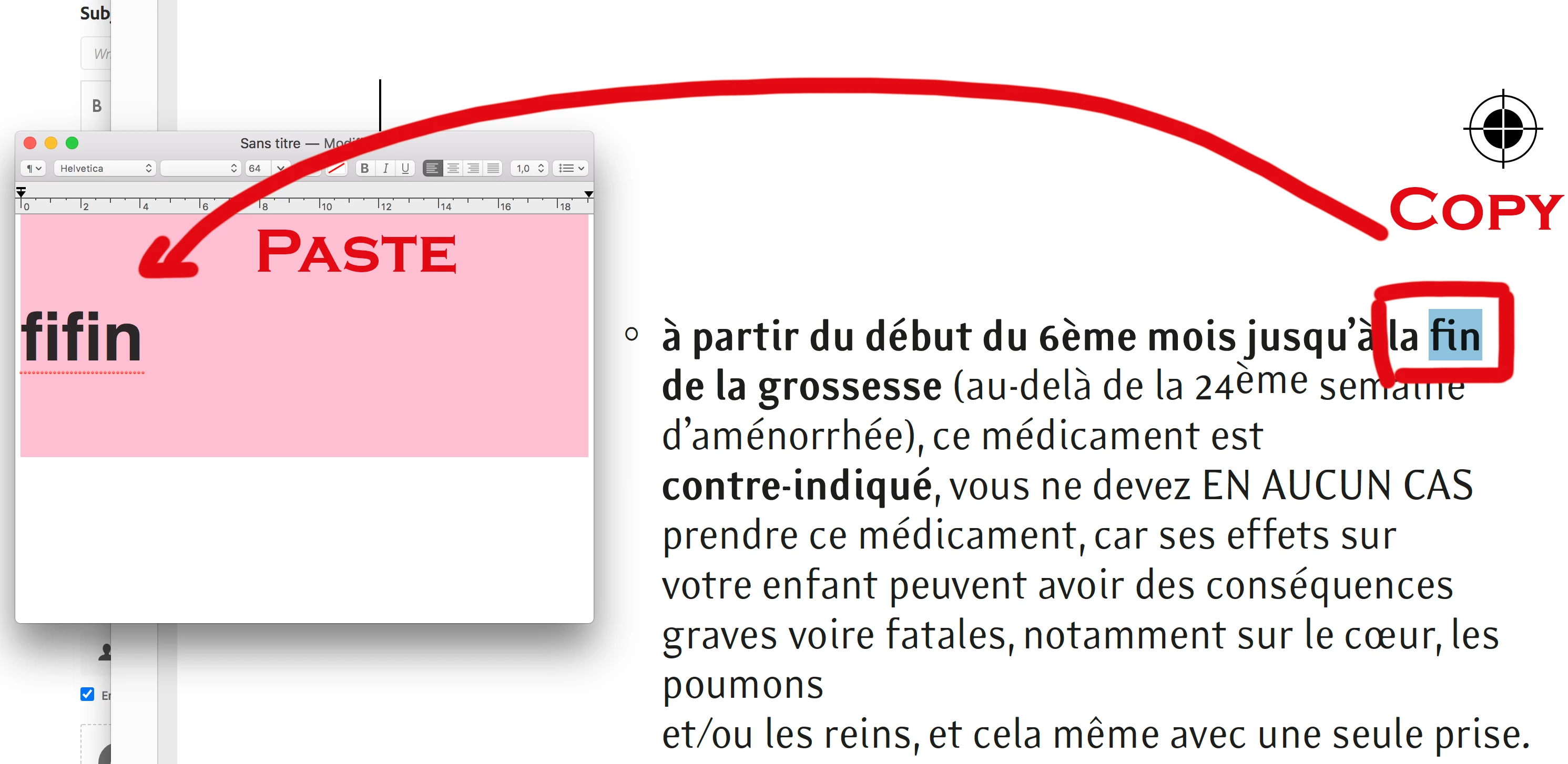

No, this has nothing to do with the ligatures.
If you changefor your Bold text to remove the stroke, the problem will disappear.
Test it.

The issue will still be there. Removing the ligatures only simplified the problem.
If you "Edit PDF" and select all the text in a block of copy (like my example attached), and copy and paste it into a Text Edit document, you can see the duplication still happens beacuse you still have two copies of the text on top of each other in the Bold parts; one being your added stroke and the other being your fill.
Acrobat doesn't know that these two copies aren't supposed to be that (A PDF is merely a print document of print instructions and is not meant for editing like this).. it simply "recognizes" a block of copy and everything in it will be selected.
Here's another way to show it. In that same block, go to "Edit PDF", click your cursor anywhere in the bold text and start deleting (back-spacing).

May 3, 2022
Okay, so there seems to be two copies of the text on top of each other on your bolded text. It looks like a .14pt stroke was added to the bold text to fatten it up. Put when a PDF is created of this, the PDF spec writes these attributes separately: one pass for the stroke and a second pass for the fill, so what you are seeing is two copies of the text on top of each other. However, the way the PDF has structured the file is that it will write the stroke for a few letters, then goes back and write the fill, then moves to a new position and the starts the next word, and so on. It seems like when you copy and paste this text, depending on where you select and how much you select, it's picking up all or part of both copies.
This doesn't solve your situation, but this is what's happening. And it's affecting only your stroked text (i.e. the bold)
