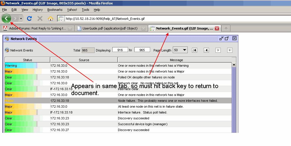

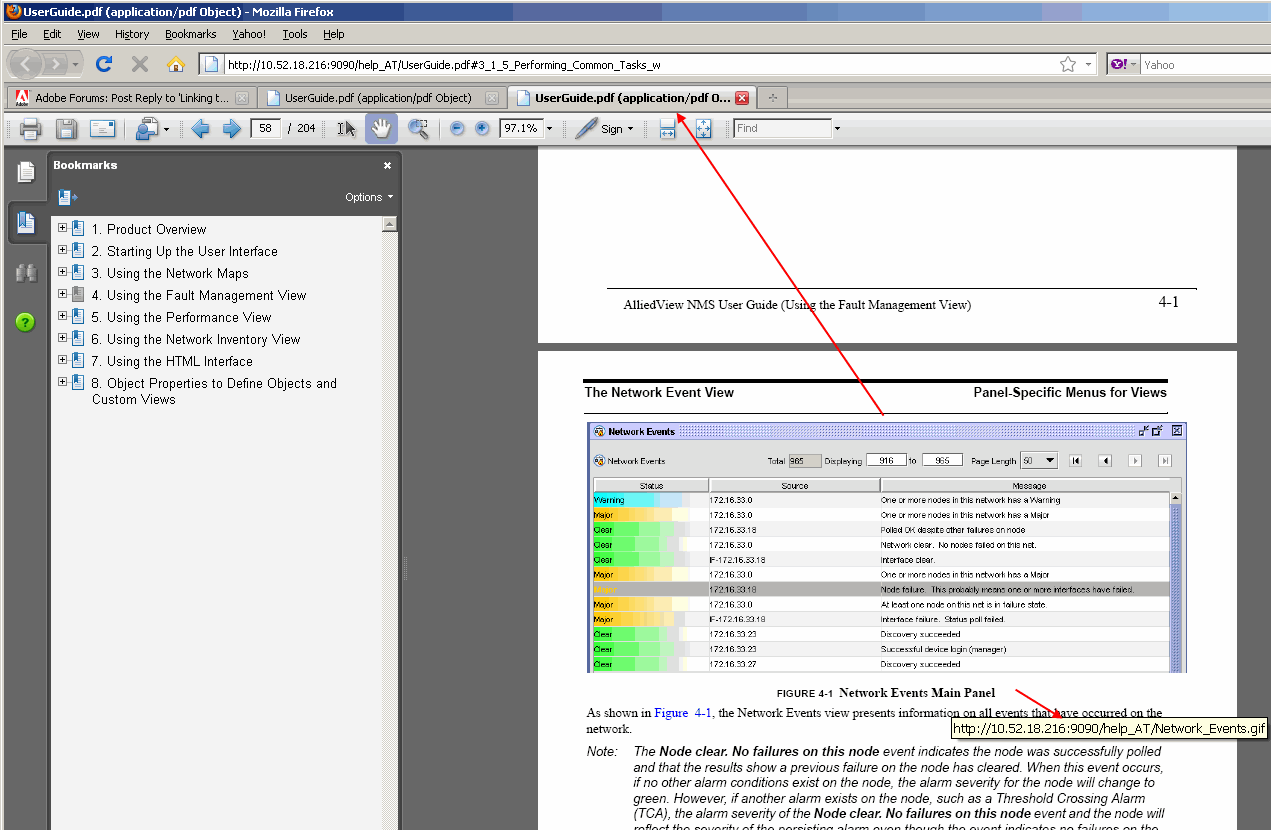

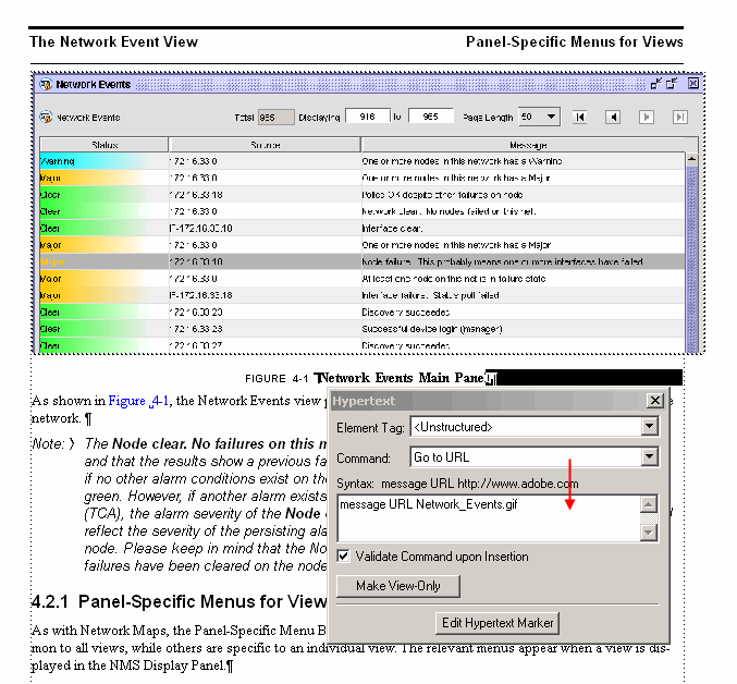

    Keith here again, with a lot of work we have the online pdf application up and running, the final issue is ensuring the figures
    (screen captures) are legible in pdf, what I have done is in Frame for the figure caption tag added a hypertext link that points to
    a gif file. There is no path because the application points to the correct directory on the webserver. When I put the pdf files on the
    web server, you can click on the caption and the figure comes up, but it is in the same tab as the pdf file, so you must click on the
    back button to return to the pdf. I would like the figure to appear in another window or tab, and usually you can select a link and drag it
    up to create a new tab for that link. I can't find an option that says 'make hypertext links appear in new window" in Frame. In Firefox
    I have clicked on the option 'Open new windows in new tab instead' and that doesn't seem to work, do I need to embed so javascript
    in Frame or the pdf? I hope the attachments make this clear.

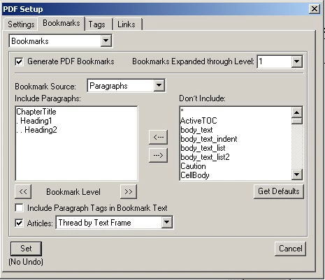

    Sorry to start up this post again, but one branch of our company wants the online help files to be pdfs (from Frame)
    with an html file to point to various pages in them. One solution seemed to be to create destinations as hyperlinks (Comment 20), but the
    ideal way would be to create them from the bookmarks, since that would match the heading content. There was mention of
    a tool to do this (http://www..evermap.com/autobookmark.asp) but that link no longer works, is there still a tool to do this?
    I use Frame 7.1 and Acrobat 8.1.4 Thanks

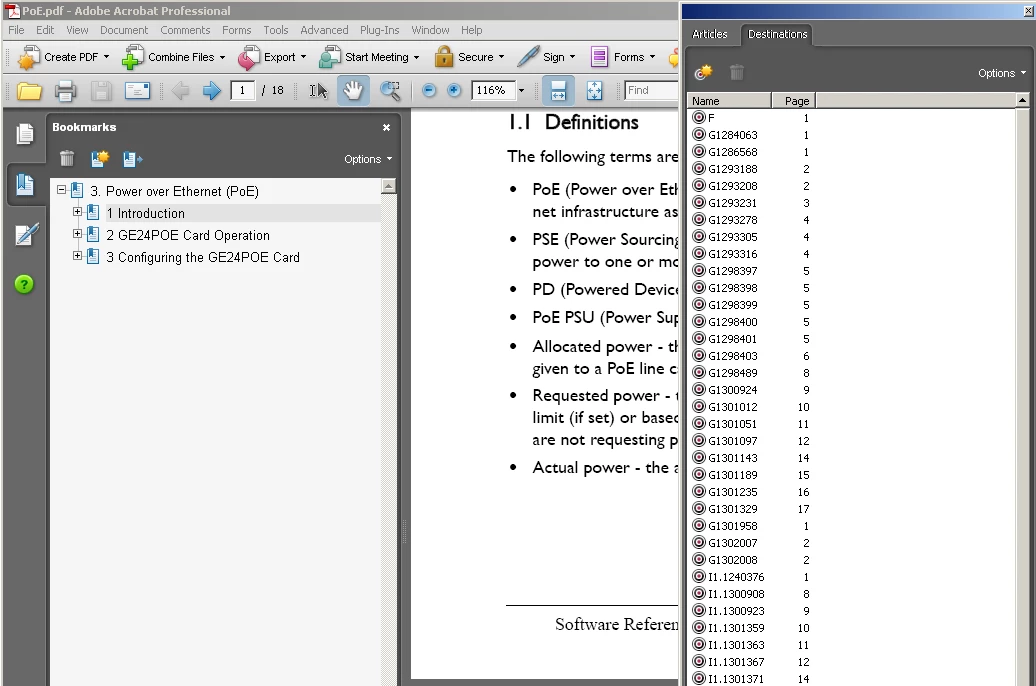

    Getting closer, I loaded the trail software, but the way I set up Frame seems to create a lot of created destinations tha that are cryptic, some of which include the destinations for bookmarks. When I create a bookmark in the pdf and use the tool, it seems fine. I'll read the manual, but my question is about Frame, is there something wrong with the pdf setup settings? Thanks

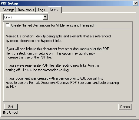

    I have a similar problem. I create my documents in Frame Maker 8,0 and I set name destination both manually and lets Frame Maker create them. From the book file I create one main pdf-file and three separate pdf-files. It is the TOC, IX and a LOP file from the main document.

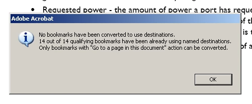

    The ARTS PDF Aerialist plug-in can also convert bookmarks and link actions from GoTo Page to GoTo Named Destination (while automatically creating the named destination).
    There's also a feature for converting GoTo Remote Destinations into Weblinks.
