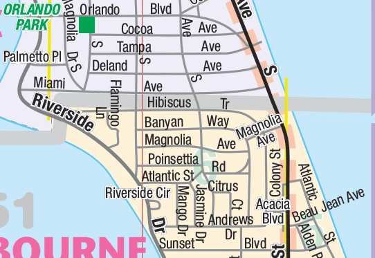

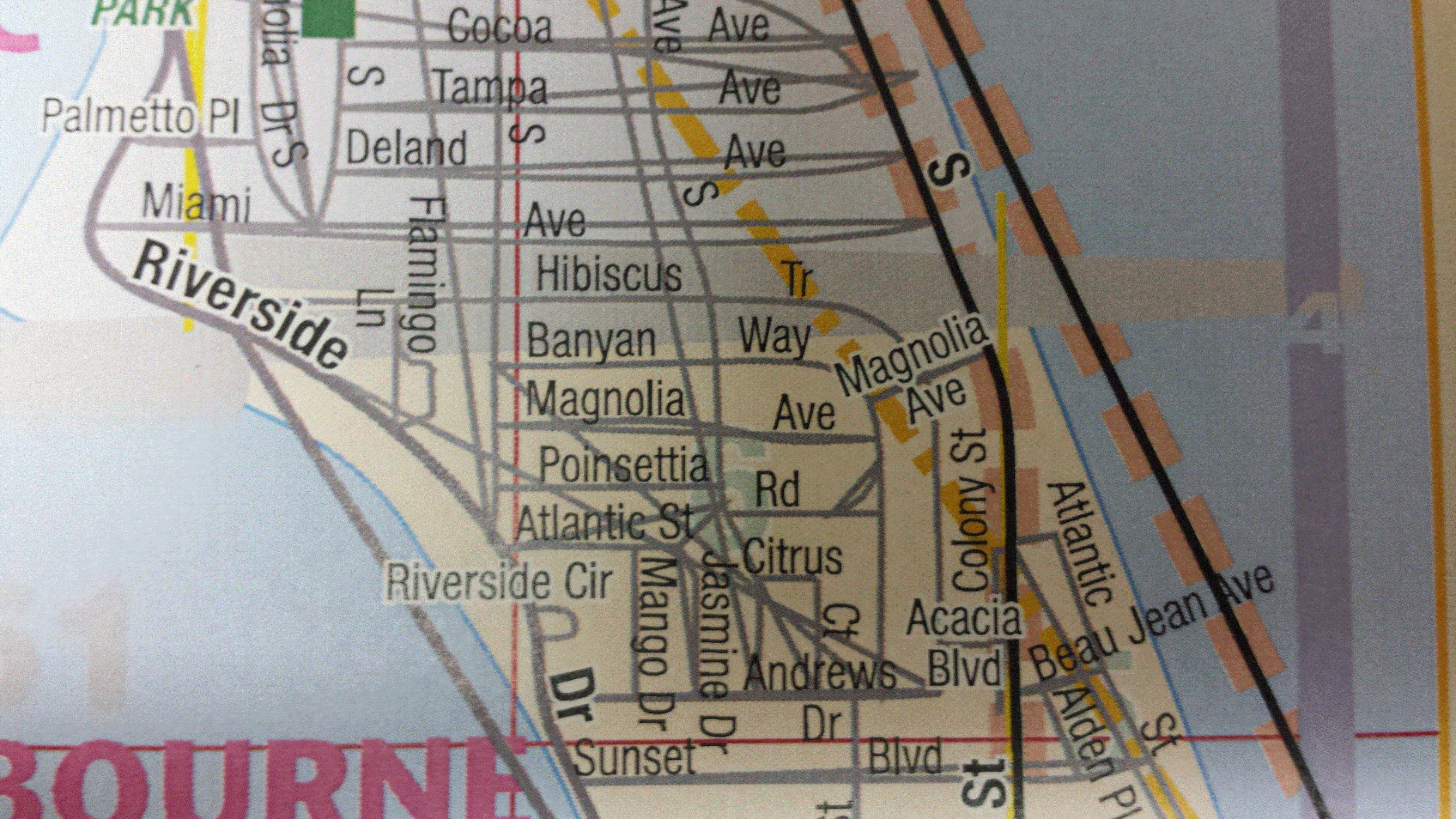

We have developed/designed a map book with 150 pages using Illustrator & InDesign. We are seeing issues with some of the street centerlines and other line layers after printing, although everything looks good on the screen in InDesign & Acrobat.
We exported using the High Quality Print preset. Here are examples (1st image is correct):
Any ideas? Thanks!

Curious to hear if you found what was wrong.  At a glance, it looks like the vector objects' bounding boxes are showing up.  Is there a way for you to use raster instead?

AbamboCommunity ExpertCorrect answer
February 28, 2018
Using raster is not a good practice.
Try first "print as image"  in the advanced tab of the Acrobat print dialogue box. Print as image is a workaround to see if the printer (driver) is the problem.
What is your OS and version? What is your Acrobat and version? What is your Indesign and Illustrator version?
Export presets are not that important for vector images. They are important for producing correct files for your print service provider at a later stage. Generally you should ask your print service provider for the correct settings.
For further advice, it would be good to have access to sample files - in a first stage the PDF file of a faulty page will be enough.
