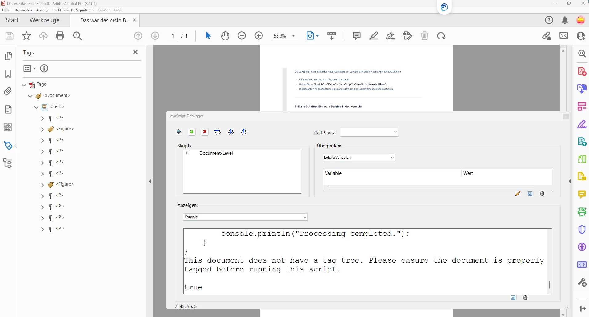

But the output is:
This document does not have a tag tree. Please ensure the document is properly tagged before running this script.
true
In the folowing picture you can see that I'm using Adobe Acrobat Pro and that my Document has also a Tag-Tree. Of course it is not the document with more than 1000 elements but the script should also work with this small document.
Maybe one of you could help me with my problem.
Regards Norbert
try67
July 28, 2025
Tags can't be accessed using a script. This is probably some AI hallucination code.
Thom Parker
July 28, 2025
I believe that Try67 is correct. You have used an AI to generate nonsensical code and are now asking us to fix it.
Besides the incorrect item mentioned by Bernd, there are several non-existant properties used in the code.  And the stated purpose of the code makes no sense. This code is truely a meaningless pile of crap.
I would suggest you ask the AI to fix it.
Thom Parker - Software Developer at PDFScriptingUse the Acrobat JavaScript Reference early and often
PDF Automation Station
July 28, 2025
There is no numAnnots document property.  Try doc.getAnnots().length;
Bernd Alheit
July 28, 2025
this.catalog gives you the access of the search catalog. This has nothing to do with the tag tree.
