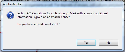

Hi, on the formatting, I used a /n for a return, to put space before the question. Actually used 2 before 'Do you have an additional sheet. works good
I also want 2 returns after 'Section # 2: Conditions for cultivation' but the /n /n shows up on the message? and does not give a return?
event.target.checkThisBox(0, app.alert("Section # 2: Conditions for cultivation /n /n Mark with a cross if additional information is given on an attached sheet. \n \n Do you have an additional sheet?",2,2)==4);
