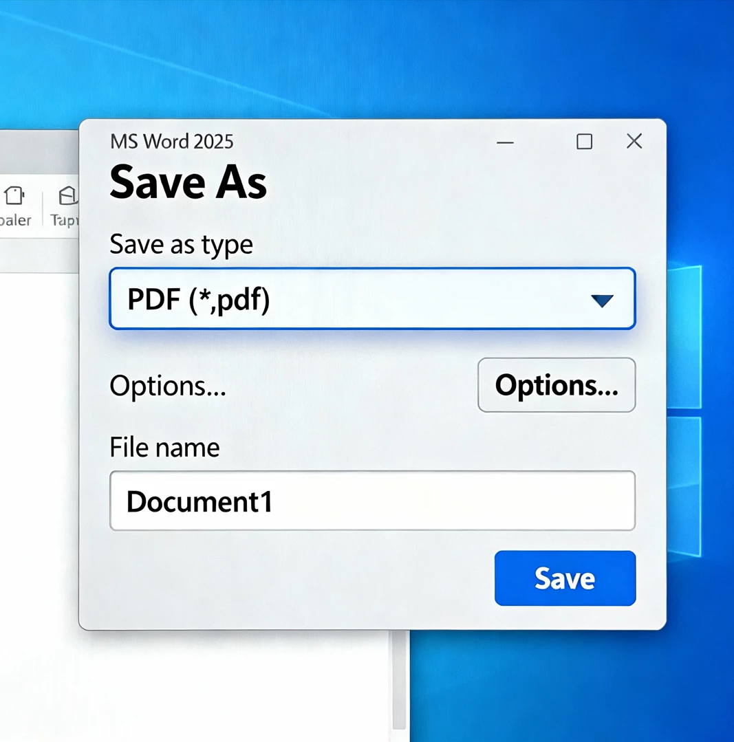

The order difference here is not a bug or an error; it is a structural issue, and it can be fixed very easily. If you are facing this issue, you may follow the steps given below:
  1. Go to MS Word > File > Save as > PDF.
  2. Then, click on options, and make sure that the “document structure tags for accessibility” option is checked.
  3. Save and then test it by copying from a new PDF document.
This will ensure that Word includes all the logical reading order tags.
