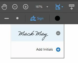

Minus sign to update my signature and initials is greyed out
I am trying to update my signature and initials in Adobe because I need to draw them instead of using the typed version. However, the minus sign is greyed out and nothing happens when I click on it.

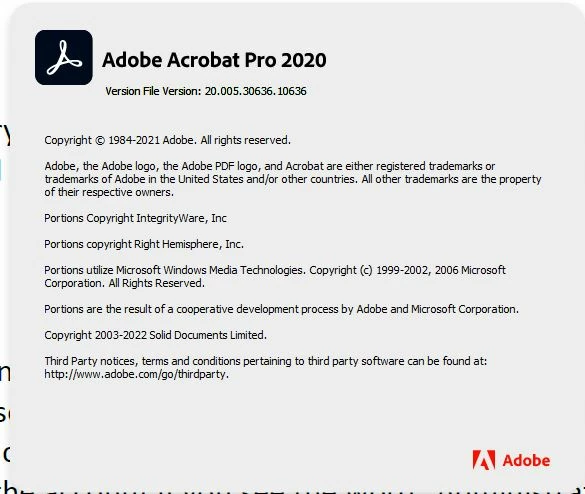

I have the same issue still. I have updated and repaired. I am running Adobe Acrobat Pro 2020 version 20.005.30636.10636
Any help would be appreciated!

March 23, 2020
Hi Caitlyn
We are sorry for the trouble. As described, you are not able to change the signature and initials in Adobe Fill and Sign  as the minus sign is greyed out.
Would you mind sharing the version of the Adobe Acrobat / Reader DC installed? To check the version of the application please use the link (https://helpx.adobe.com/acrobat/kb/identify-product-version.html)
Make sure you have the latest version 20.006.20042 installed. Go to Help > Check for Updates
Please try to repair installation (For Windows Only) Go to Help > Repair Installation
