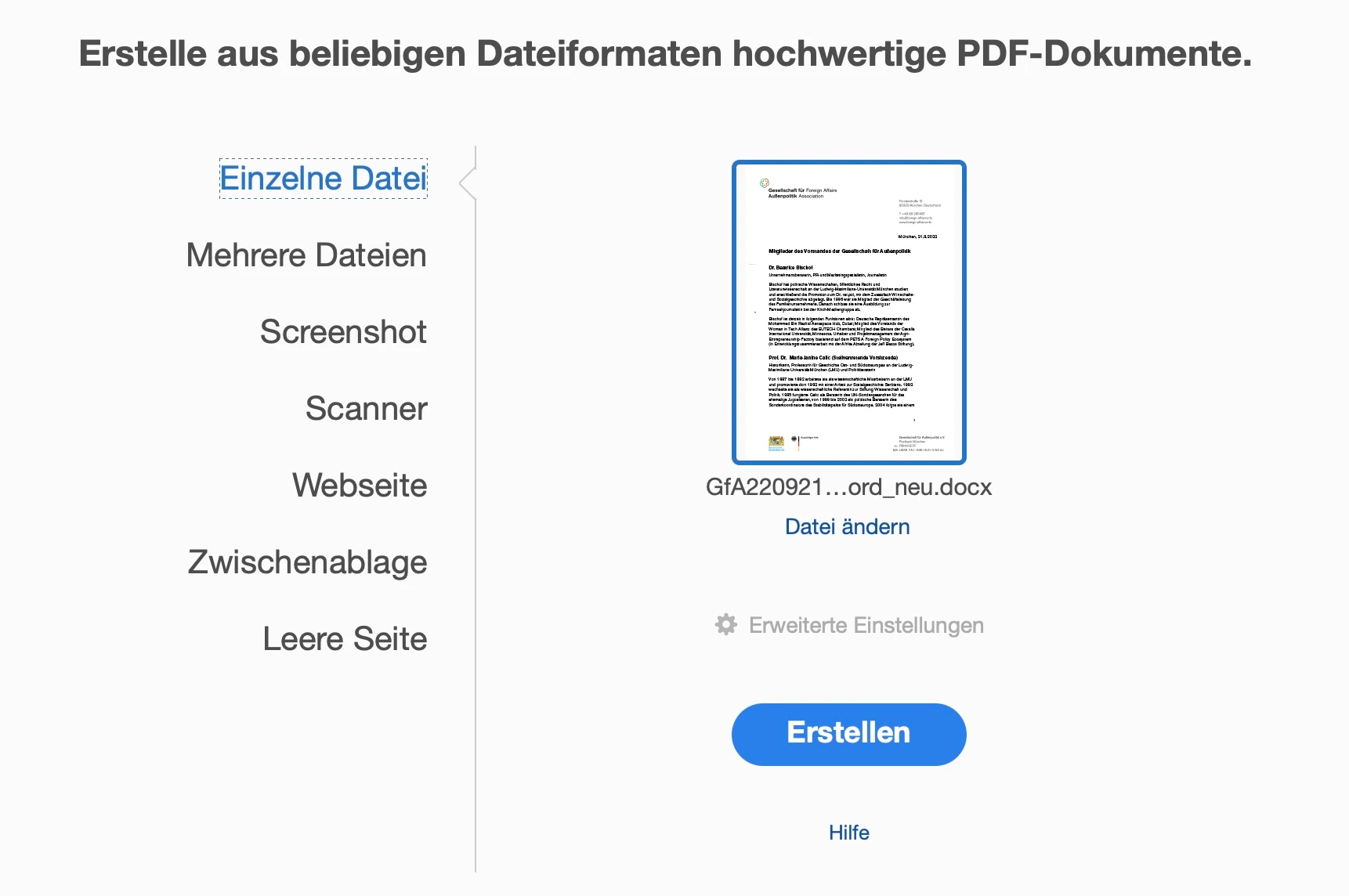

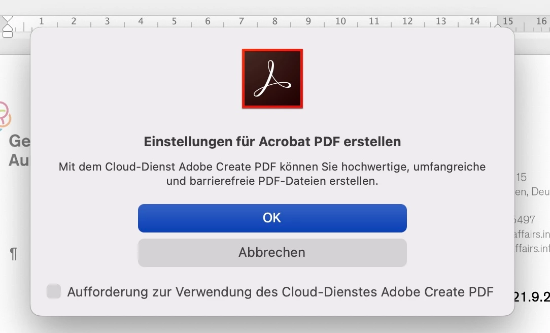

This seems to be related to my issues. I can not export from Word using the Adobe Ribbon, because my choosen font gets dropped and the PDF uses a diffrent one instead. When i click on the options button in the Adobe Ribbon I can not do any type of settings. I only get some information on the Cloud-Service, thats it. (First Screen)
When I use Adobe to create a PDF from a Word-Document the Setting-field is also not clickable. (Second Screen)
(Exporting from Word works using the Microsoft Save As, but i can not find any settings for images etc.)
