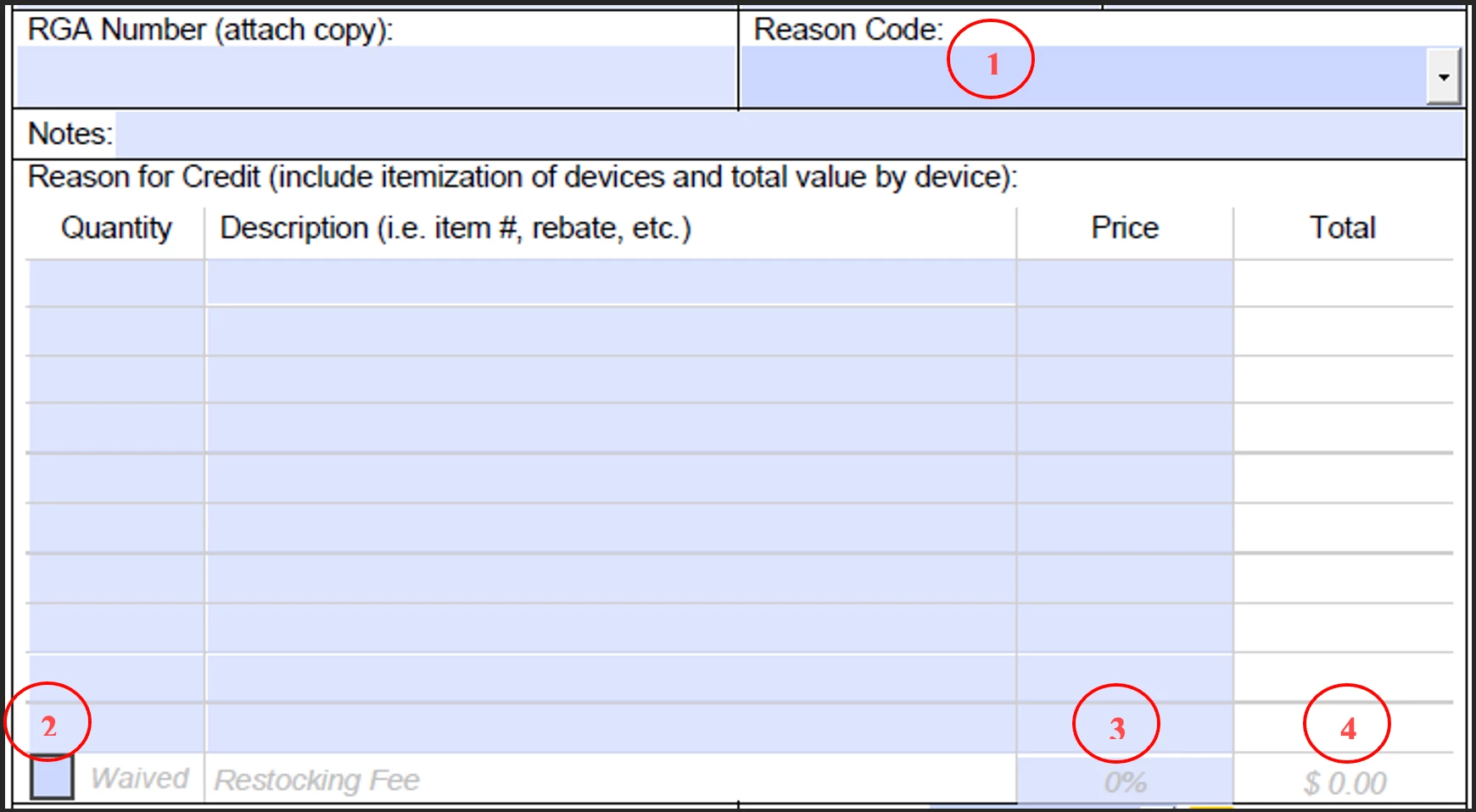

I want to have the form automatically calculate/format the last row line based on fields labeled 1 and 2. It requires mutliple if statements with multiple conditions inside. I'm not sure if that's actually possible or not, but any help would be appreciated!
Below are issues I'm stuck on for fields 3 and 4. The table consists of the conditions with the desired result. The current script is underneath that.
For 3:
The number value entered in the targeted field doesn't change with any of the conditions.

For 4:
There's a hidden field that calculates the subtotal based on the other lines' total. When the waived box is checked the  targeted field sets the text to match the last condition instead of the previous.

Correct answer try67
Did you set the Export Value of the check-box to "On" yourself? Because if you didn't, the value that's normally used is "Yes" (while the value for an unchecked field is always "Off"...). You can change it to "On", but don't assume that's the default state.

try67Community ExpertCorrect answer
November 27, 2022
December 1, 2022
That worked like a charm once I changed the script to reflect "Yes". I'm self-taught and it was my first time using the custom calculation script option. Hadn't registered something so simple as the export value was the issue. Thank you for the help!
