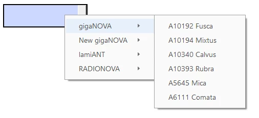

I can now make MouseUp to populate the submenu. But as you say, we'd require a script to keep the item when selected. I do not need to do multiple selection, but I need submenu to group different products like below. May you please kindly advise how should I keep the item when I select? My first sript is as below:
var cChoice = app.popUpMenuEx
{cName: "gigaNOVA", oSubMenu:
[ {cName: "A10192 Fusca"},
{cName: "A10194 Mixtus"},
{cName: "A10340 Calvus"},
{cName: "A10393 Rubra"},
{cName: "A5645 Mica"},
{cName: "A6111 Comata"} ]
{cName: "New gigaNOVA", oSubMenu:
[ {cName: "A10192H Fusca-H"},
{cName: "A10194H Mixtus-H"},
{cName: "A10340H Calvus-H"},
{cName: "A5645H Mica-H"},
{cName: "A6111H Comata-H"} ]
{cName: "lamiANT", oSubMenu:
[ {cName: "SR4L002 Lucida"},
{cName: "SR4G008 Sinica"},
{cName: "SR4C033-L Latona Left"},
{cName: "SR4C033-R Latona Right"},
{cName: "SR42W001 Mutica"},
{cName: "SR4C005 Similis"} ]
{cName: "RADIONOVA", oSubMenu:
[ {cName: "M20047-1"},
{cName: "M20057-1"},
{cName: "M10578-A2"},
{cName: "M10578-A3"},
{cName: "M20048-1"},
{cName: "M20050-1"} ]
Thom Parker
June 1, 2020
What do you mean by keep selection? The popup menu is created dynamically. Do you want the previously selected item marked? Please post to a new thread and explain more clearly what it is you want to do.
You can read more about popup menus here.
https://www.pdfscripting.com/public/Creating-Popup-Menus.cfm
