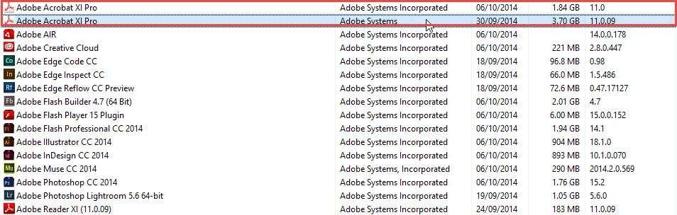

October 10, 2014
I did your recommendation and let me say that issue persists in the new fresh installation. Other issue that I can see is that Acrobat is installed twice, as you can see in the Programs and Features panel, on the Control Panel. I'm using Windows 8.1 x64 with all Adobe CC 2014 products.
The problem is that uninstalling any Acrobat version (or row), Adobe Acrobat is uninstalled fully.
Other issue detected with multiples instances is related to the Adobe CEF Helper application. This application appears, three or four times in the Task Manager.
Really annoying this issue.
Regards
César Qüeb
October 10, 2014
It's not installed twice. Don't worry about the two entries, it's normal with CC.
