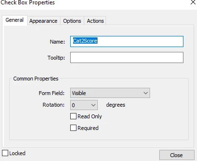

THANK YOU so much for replying! I did as you said but it's not working. Do I need to put a value in the check boxes labeled Sleep 1 etc? I did have them at 1 and then Yes but nothing happened. The only thing that changed was the 'Choice2" box went black after I entered the calculation.
This is what I made the choice boxes look like and then then the code I changed to match my boxes. I also named my fields what you put in your example and nothing happened.
