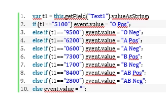

I'm obviously not a software engineer, I'm a clinical laboratory scientist, so I'm doing my best to understand the details, but I am an amateur at best.  I inserted the real ABO values in the code, and deleted the "// etc."  Was is correct to deleted the "//"?  And, when I paste it into the form, do I need to delete the numbers at the beginning of each line?

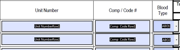

Thank you for sending the script.  Must I create two different fields, or is there a way to scan into a single field, and have the interpretation show up in that same field?  Or, can I overlay the two fields somehow?  This is a screen shot of the current form.  I don't like the drop down menu under the Blood Type column because it can't be scanned like the two fields prior to it in the same row (I already inserted a script to auto-tab from one field to the next).  I want to scan the blood type ("5100") in the "ABO1" field and have the interpretation of "O Pos" show up in the same spot (and then auto-tab to the next row).  Is that possible?
try67
February 9, 2018
I would use two fields. The first one can even be hidden.
