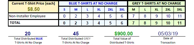

I need help in creating a custom calculation script using JavaScript.  I have zero experience with JavaScript so this is all very brand new to me.
I converted an Excel form to a fillable PDF.
I have a PRICE field, TOTAL DISTRIBUTED BLUE T-SHIRTS field, TOTAL DISTRIBUTED GREY T-SHIRTS field and a TOTAL VALUE OF DISTRIBUTED T-SHIRTS field.
The PRICE field is fixed as $8.50 [this field is read only].
The TOTAL DISTRIBUTED BLUE T-SHIRTS field is calculated based off of the total combined quantities entered for sizes S, M, L, XL, 2XL and 3XL.
The TOTAL DISTRIBUTED GREY T-SHIRTS field is calculated based off of the total combined quantities entered for sizes M, L, XL, 2XL and 3XL [no S offered in grey].
The TOTAL VALUE OF DISTRIBUTED T-SHIRTS field should be the sum of the TOTAL DIST'B BLUE + TOTAL DIST'B GREY x $8.50.
Adobe offers a Sum , Product , Average, Minimum & Maximum only or entering a calculation written in JavaScript.
Shown below, the $900.00 is a simple calculation of 20 x 45.  However, I need the end result to show a total of 65 [20+45] t-shirts times $8.50 each for a total value of $552.50.

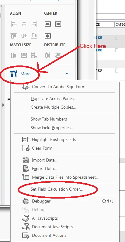

Thom Parker
May 11, 2019
Sounds like a calculation order problem.   You can set the order when Acrobat is in "Prepare Form" mode.
