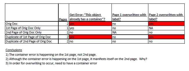

I have a program where I use an action wizard to label pdf files using java script.  Before the java script step, I use the header/footer to shrink the pages.  Within the "Header & Footer (Add)" Option, I selected "Appearance Options" and checked the "Shrink document to avoid overwriting***" and made sure "Page Range Options" is set to "All Pages."
Most of the time, the pages within the pdf are shrunk and a label is applied.  However, sometimes, I run into a pdf file where I get an error “this object already has a container.”   I did some experimenting and here is what i figured out on my 2-page document where the 1st page is labeled fine and the 2nd page gets over-written.
If anyone can help me understand how to prevent the subsequent pages from being overwritten when there is a container error on the 1st page, please let me know.

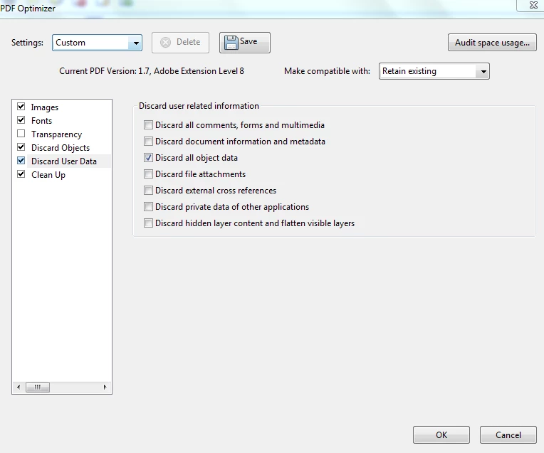

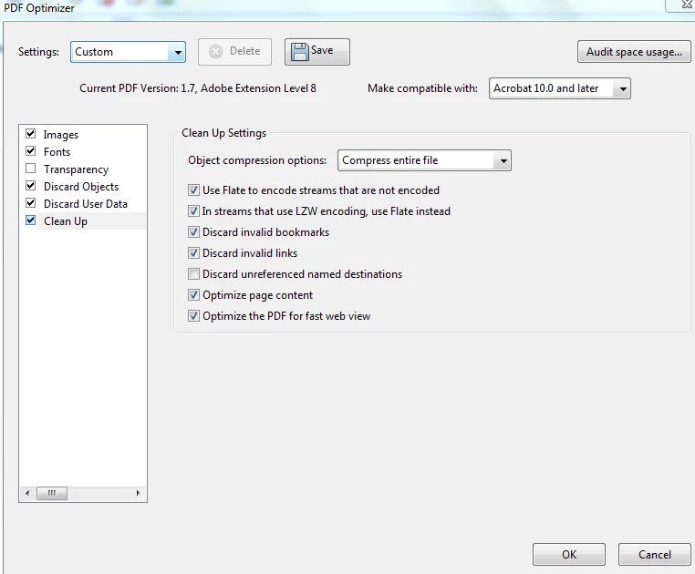

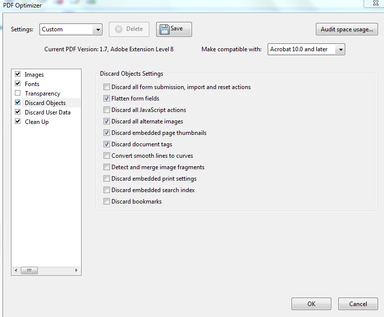

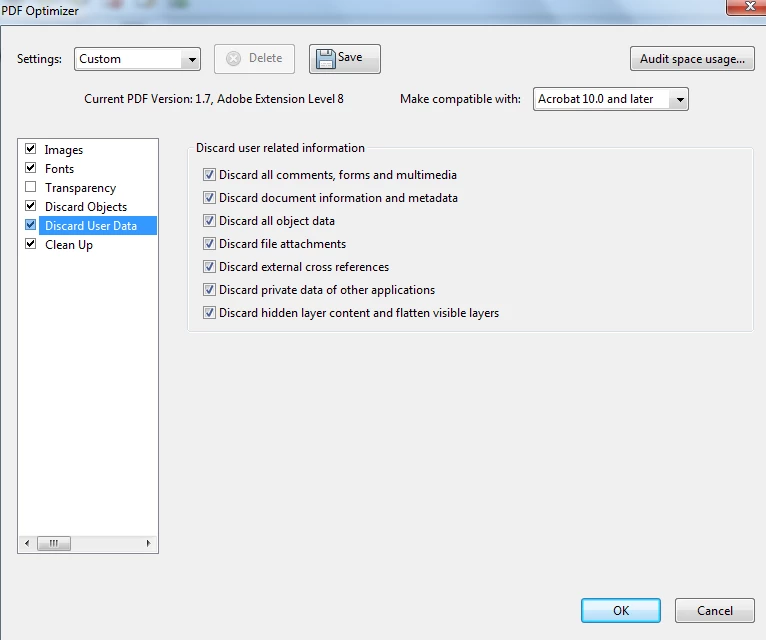

I just figured it out.
Before I execute my action wizard, I saved file as PDF Optimizer and checked off the following, and it worked.
I don't know exactly what featured that I checked solved the problem and need to step through them to figure out which one it is. Regardless, I am just glad I found a solution and wanted to share.
suemo22Author
March 27, 2017
Ok my previous post included checking everything I thought could have an impact but I narrowed it down.  All I needed to do is check the following to disregard the container and label pages without over-writing anything:
