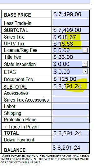

I have a form that adds 8 fields up for the Subtotal. One of these fields is multiplied by a number with 6 decimal places. So currently, even though it only shows 2 decimal places, I believe the subtotal is rounding down based on that calculation, and I need it to round up.

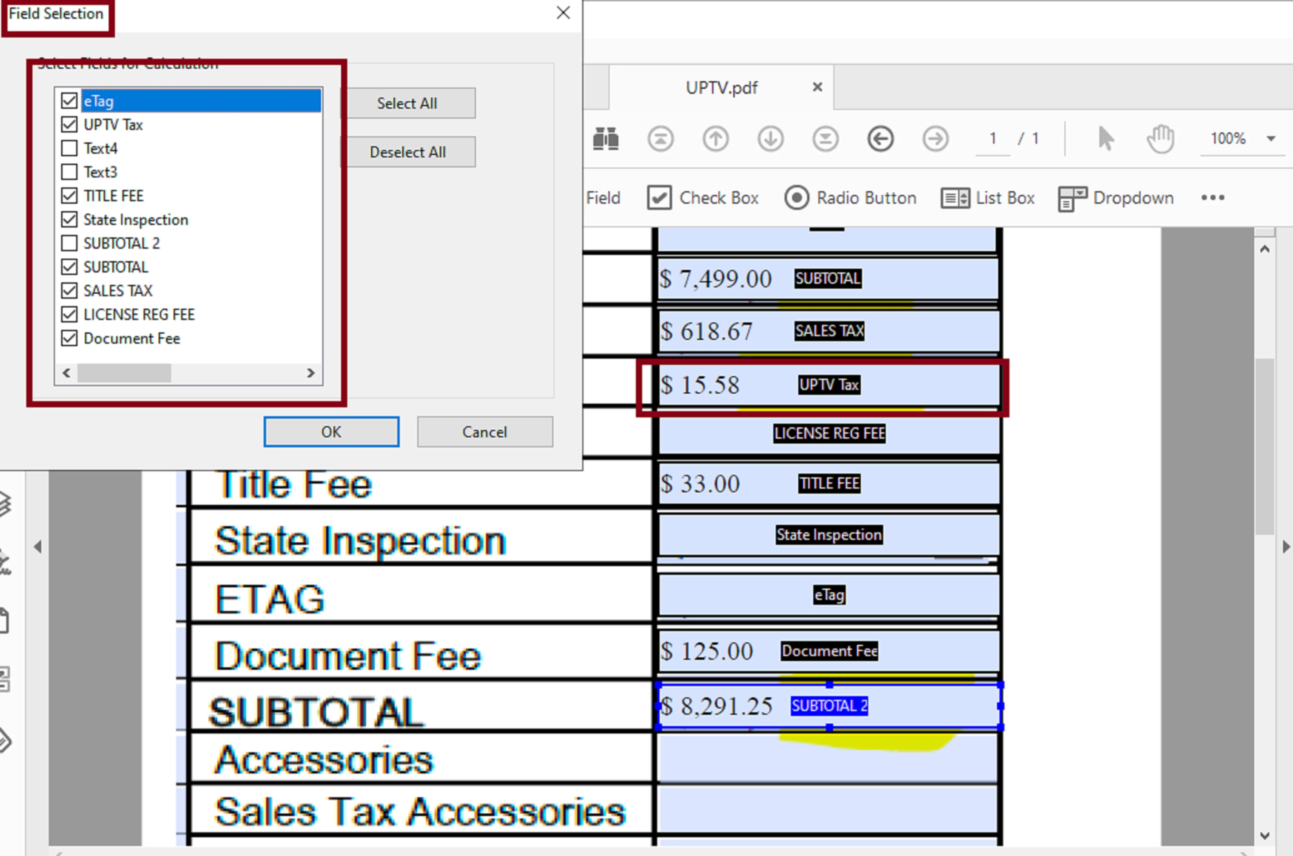

So after the calculation, my result ends up as 8291.242923, which is why it keeps rounding down to .24. It's because my UPTV Tax number is multiplied by a number that is 6 decimal places long. The other fields round correctly in their 2 decimal format, and this field IS rounding correctly, but I need it to round up so that the math showing on the paper is correct (xxx.67 + xx.58 = xxx.25 not .24)....ugh, I hope that makes sense. I really appreciate your help today.
I recreated your table, and it worked on my end, but first, You may need to format every field to Number with 2 decimals.
I also will assume the Unity Property Value tax is .001919 since when I add the numbers that you had sahred in your screenshot it calculates a total of $15.58.
In the UPTV Tax field I used the following custom calculated script:
event.value = (this.getField("SUBTOTAL").value+this.getField("SALES TAX").value )*.001919;

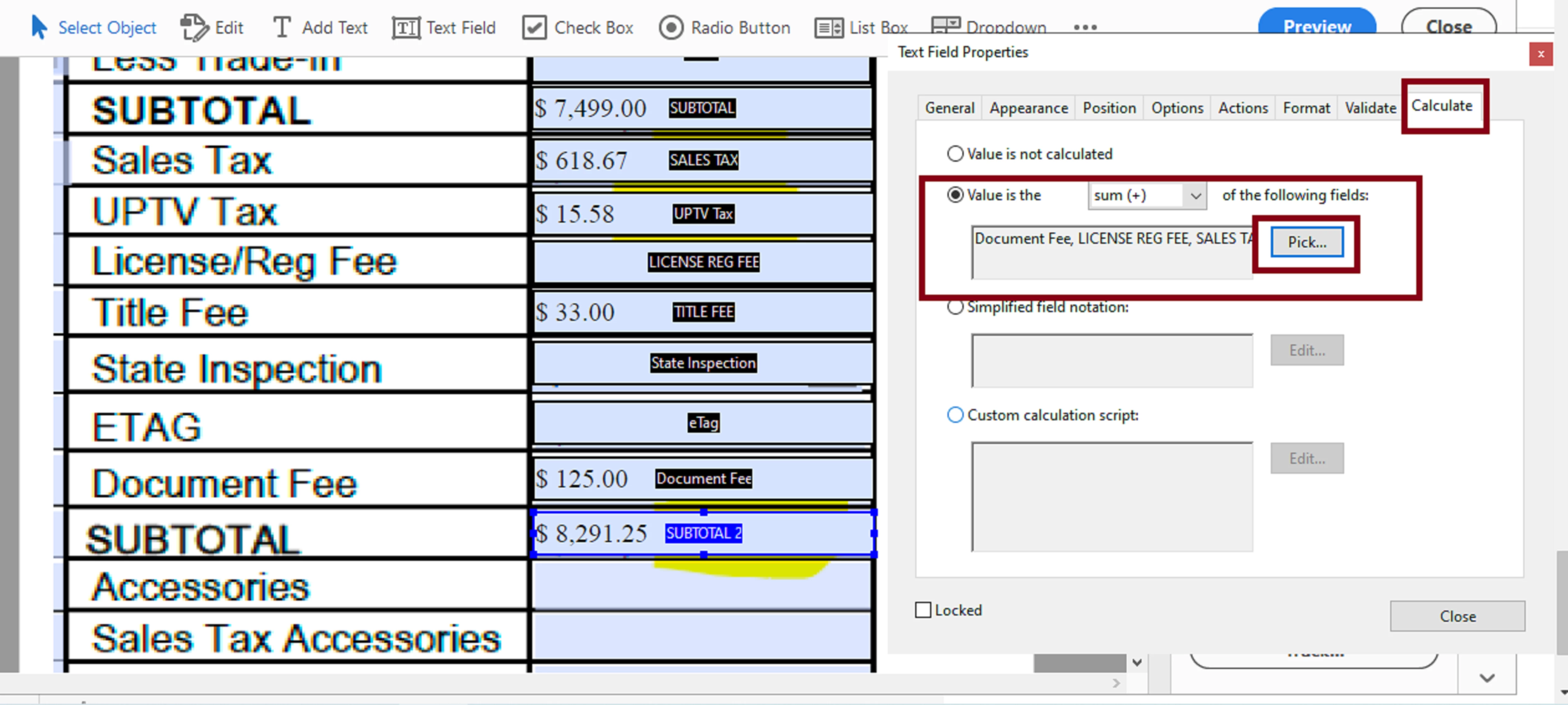

And in the "SUBTOTAL 2" field you can use the Acrobat's built-in "sum (+)" feature in the calculate tab. See slide :
When you click on the "Pick" button just select the fields that will be used to add their values:
This actually rounded perfectly as you can see in the slide above under the "SUBTOTAL 2" field.
