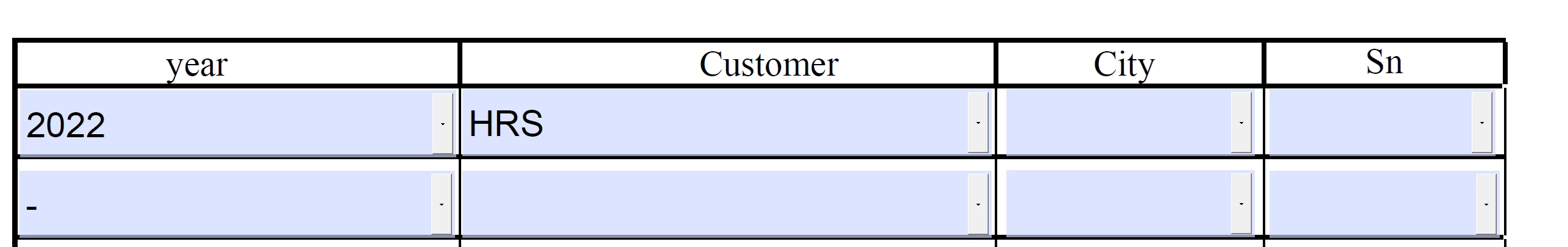

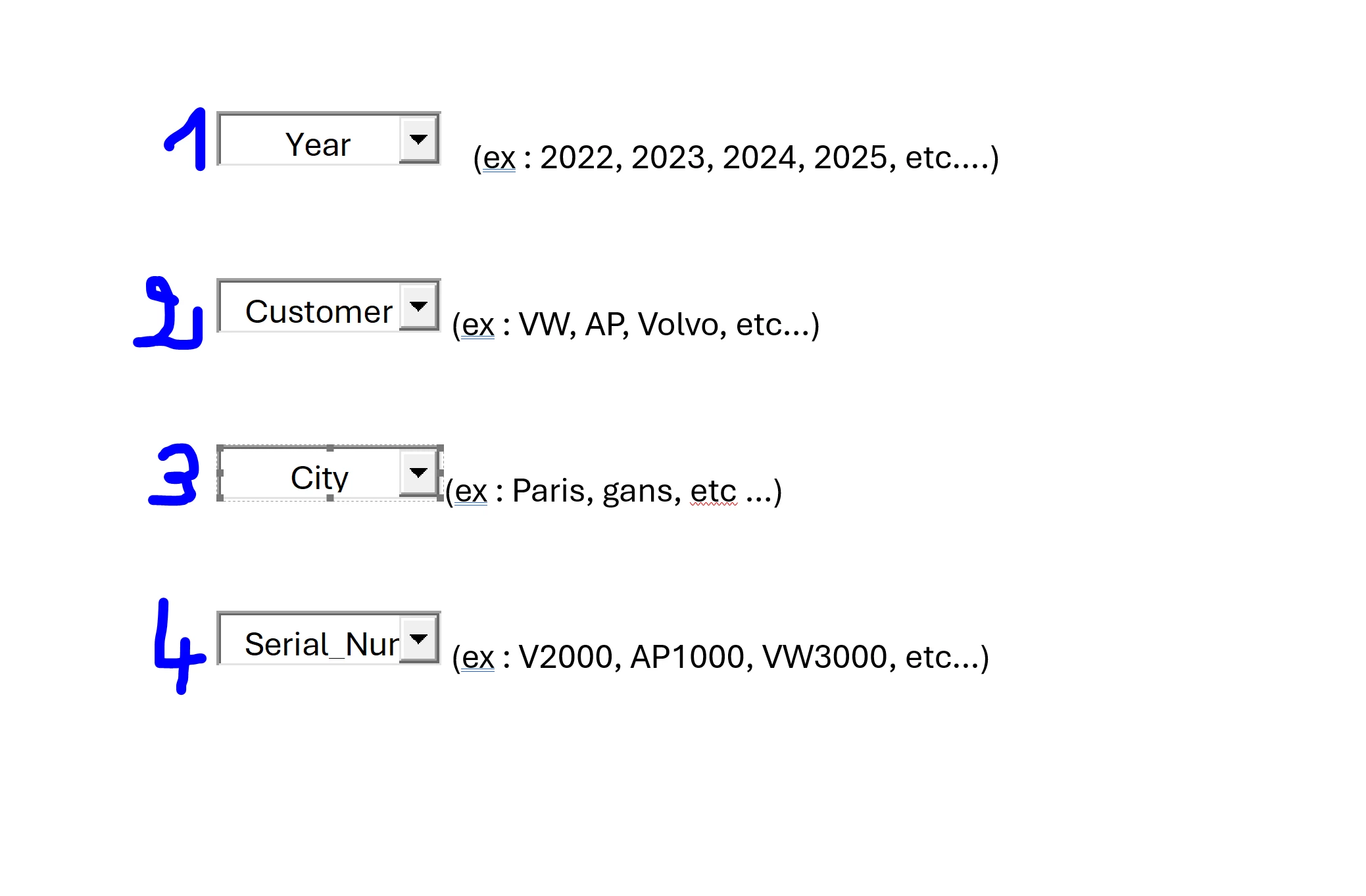

several parts are delivered to different customers in different years and city.
I would like dropdown 4 to display only the serial numbers of the items delivered that year, depending on the year, customer and town selected.
-- some information is pre-recorded for example (as in the photo)
By default, only drop-down 1 is displayed.
when I select a year, drop-down 2 is displayed,
when I select a customer, drop-down 3 is displayed,
and when I choose city, I can't display the serial numbers.

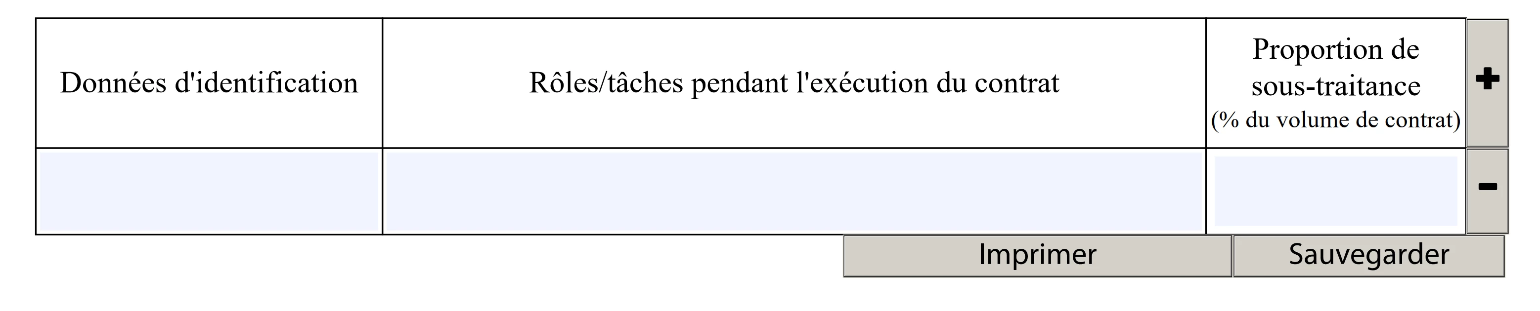

  1. is it possible to create a table like the one below in abode, so that + allows me to add rows and - to reduce them?

The page content in a PDF is fixed. It is not dynamic, so there is no way to add new rows to a table.
For the dropdowns, it sounds like you want the entries in one dropdown to be set by a selection in another drop down.
Yes, this is possible. The first article linked below covers this topic. However, if populating the entries depends on several other other dropdowns, then the script must be a calculation script on a hidden field.
Here are some helpful articles on programming lists.
https://acrobatusers.com/tutorials/js_list_combo_livecycle/
https://acrobatusers.com/tutorials/change_another_field/
https://www.pdfscripting.com/public/List-Field-Usage-and-Handling.cfm

** concerning the ListProgramming_Part1_XFAForm.pdf document, this is actually what I wanted to do on another document.
I suppose it's impossible to do this with Adobe?
** without first having to ask for your authorisation, I took the liberty of using one of your codes in the
to the ListPrograming_Part1_AcroForm, i have on question, for ex :
Chasis: [ ["-","None"], ["Rear Bracket",205.95]],
i can do
2022: [ ["-","None"], ["HRS",SN]],
Sn is the serial number
in the year 2022, for example, Test may have several serial numbers. How do you fill this in?
I was able to modify the first two dropdowns, but for the rest, I'm really lost, can you please help me?
