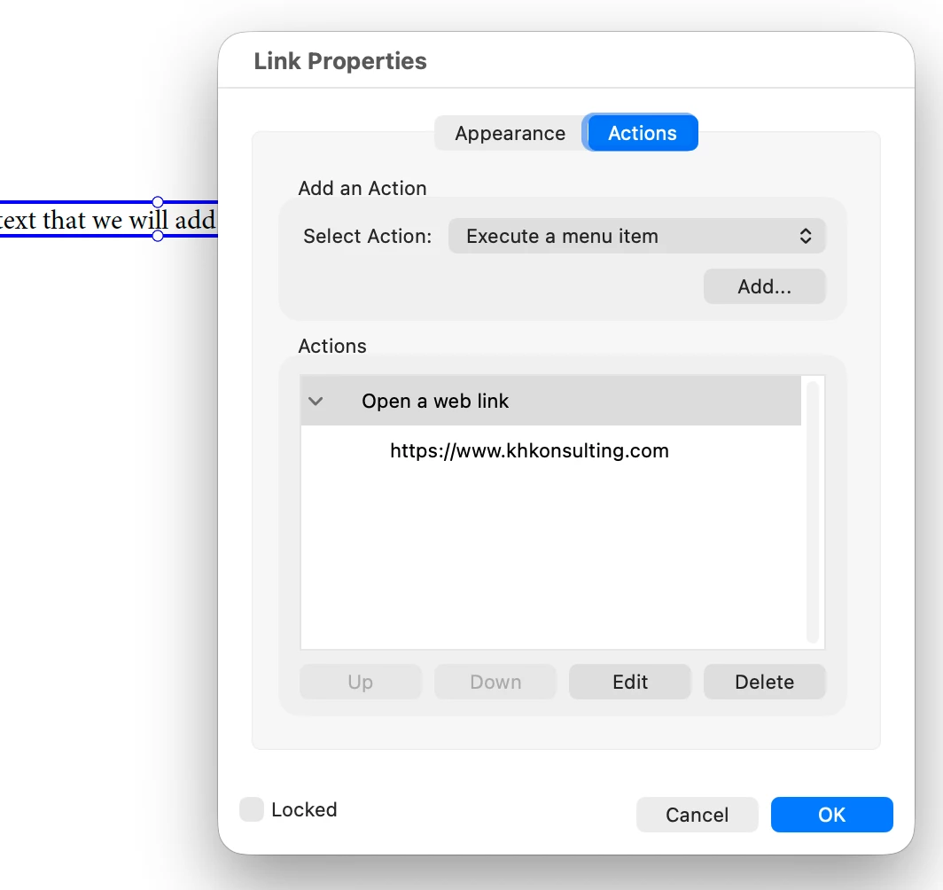

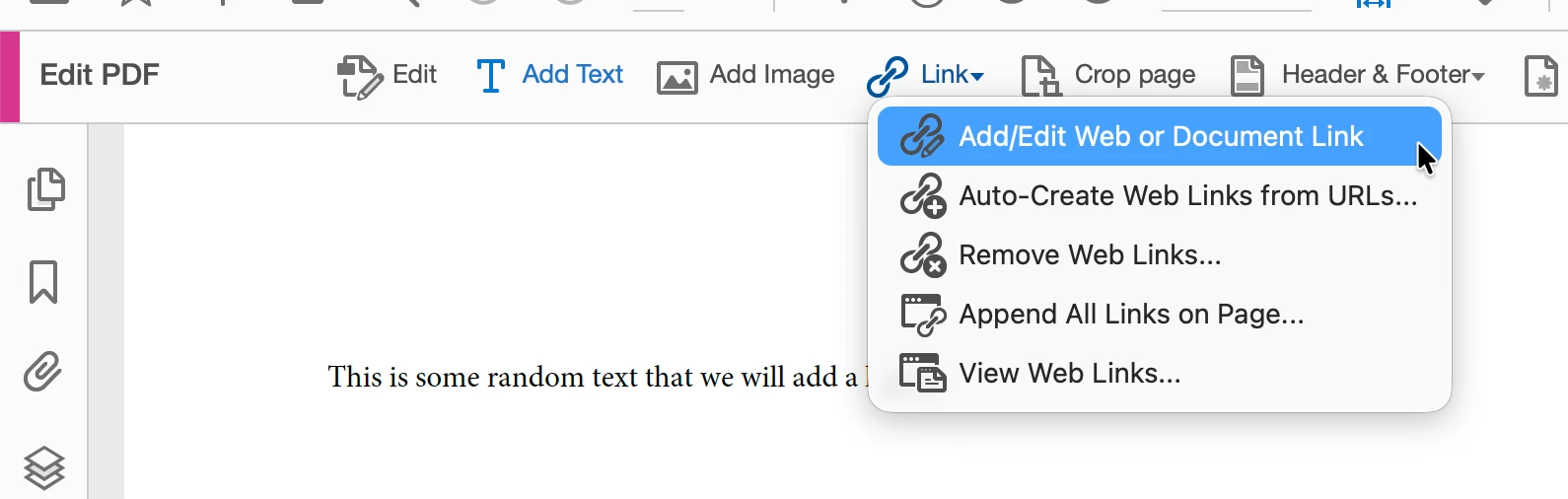

    Do you have Adobe Acrobat (not just the free Reader)? If so, you can edit links. In the “Edit PDF” tool section, you will find “Link” with a submenu:
    There is the “Add/Edit” function to modify an existing link.
    Once you select the tool, you will see the links in the document. Double-click on one and you will get the link properties dialog:
    The “Actions” tab will allow you to edit the target of your link.
