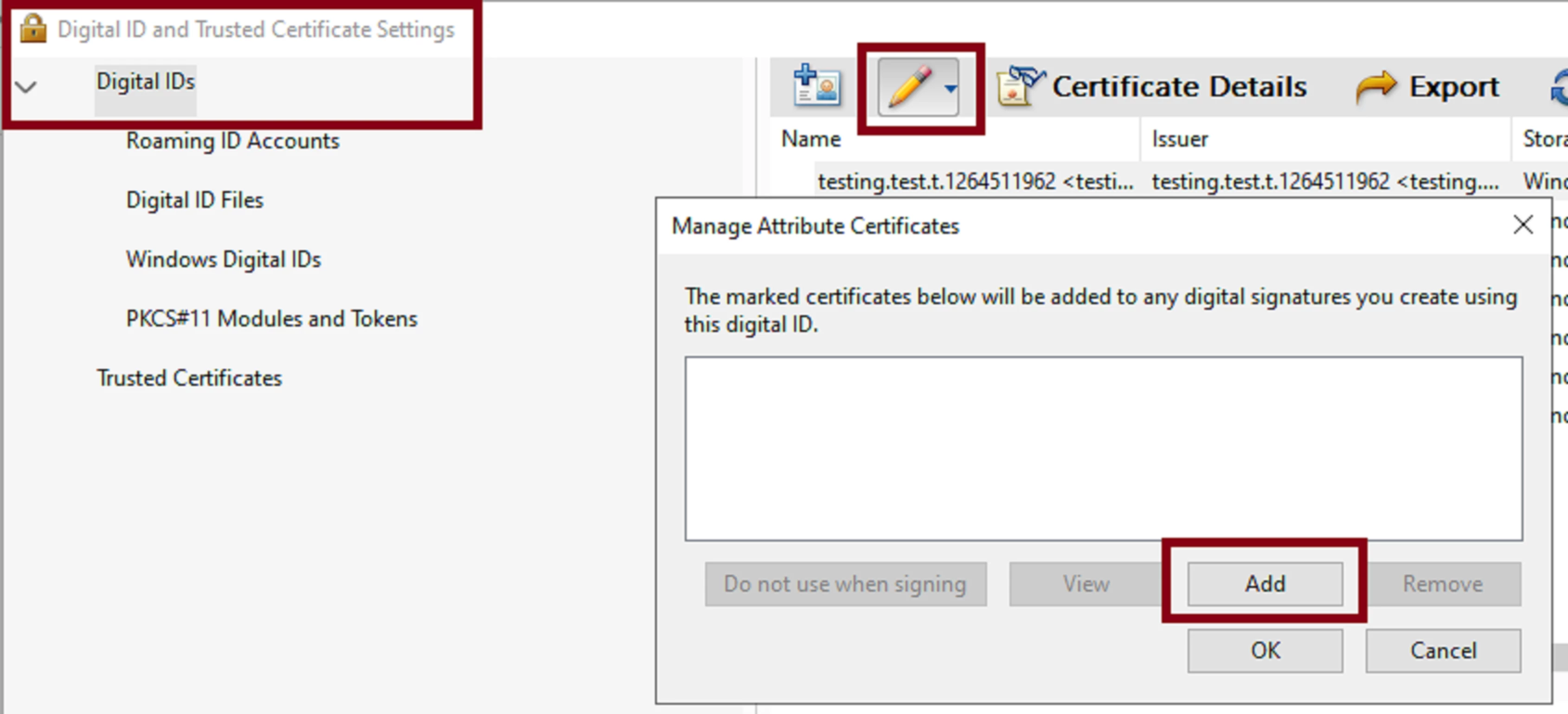

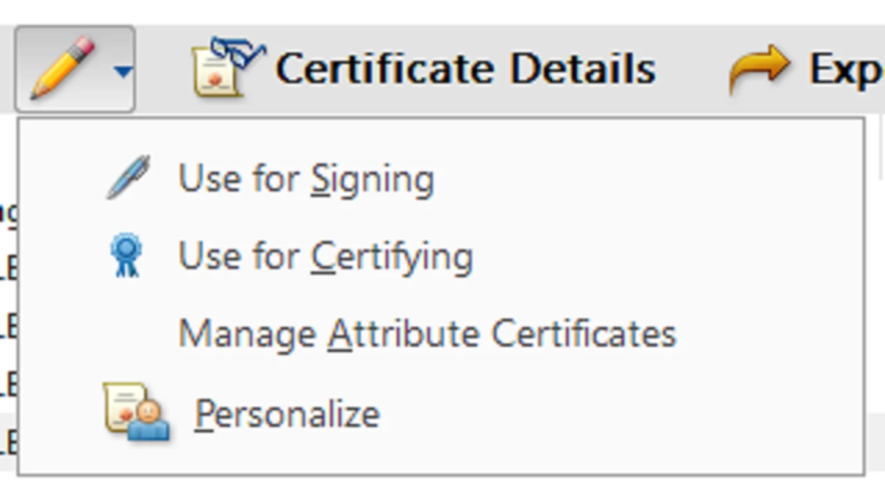

Have you tried going to  Edit -->> Preferences --> Signatures--->>> see the section "Identities and Trusted Certificates" -->>> click on "MORE"--->>> "Digital IDs" ?
In the window dialogue box "Identities and  "Digital ID  and Trusted Certificate Settings" to the right is a list of all your current digital IDs.
See these additional configuration options:

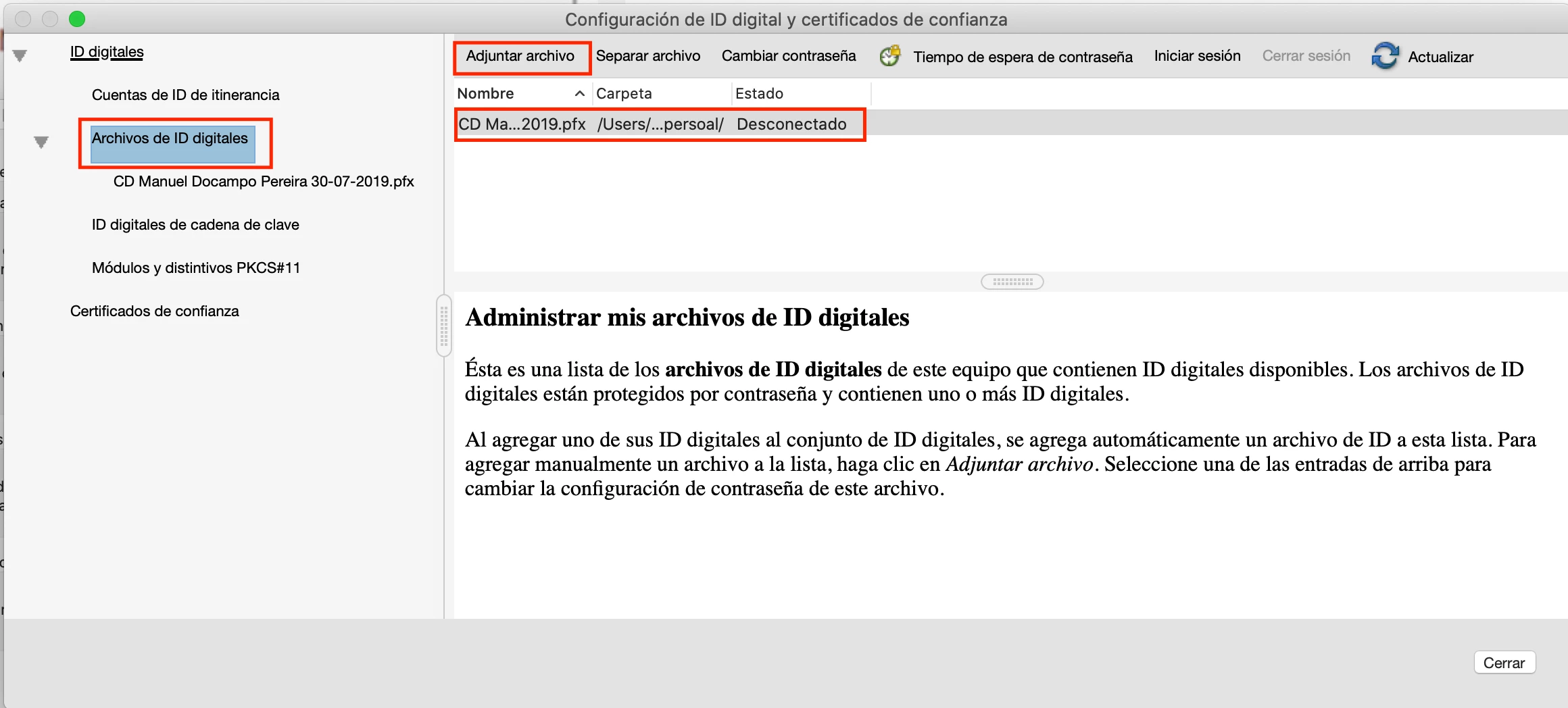

Well, this last suggestion helped me a lot, thank you, although the result was not what I had expected.
In the configuration options "Digital IDs" I found Digital ID files where I can add any digital ID. There I browse my Mac and selected the file with the digital ID. Now I can sign with this file (it has "nothing to do with the digital ID installed in my Mac" although it is the same digital ID.) and I have to type the digital ID password every time I have to sign a document. Besides, I suppose I cannot change the location of that file. It's not what I had expected, because with the old one I didn't have to type the password, but it works
