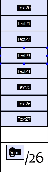

My first post! I am looking to have my text fields each be worth 1 point, so when they fill out the field it adds into my sum.  I cannot see a way to have my text field be fillable but still have a value? thanks for any help

September 15, 2021
Last field in your photo is 27 and your sum is 0/26, how many fields you have and how are they named?
September 15, 2021
Thanks for all the helpful ideas! There are 26 fields (I just had to remove #12) thus 27. They are named Text1, Text2 etc

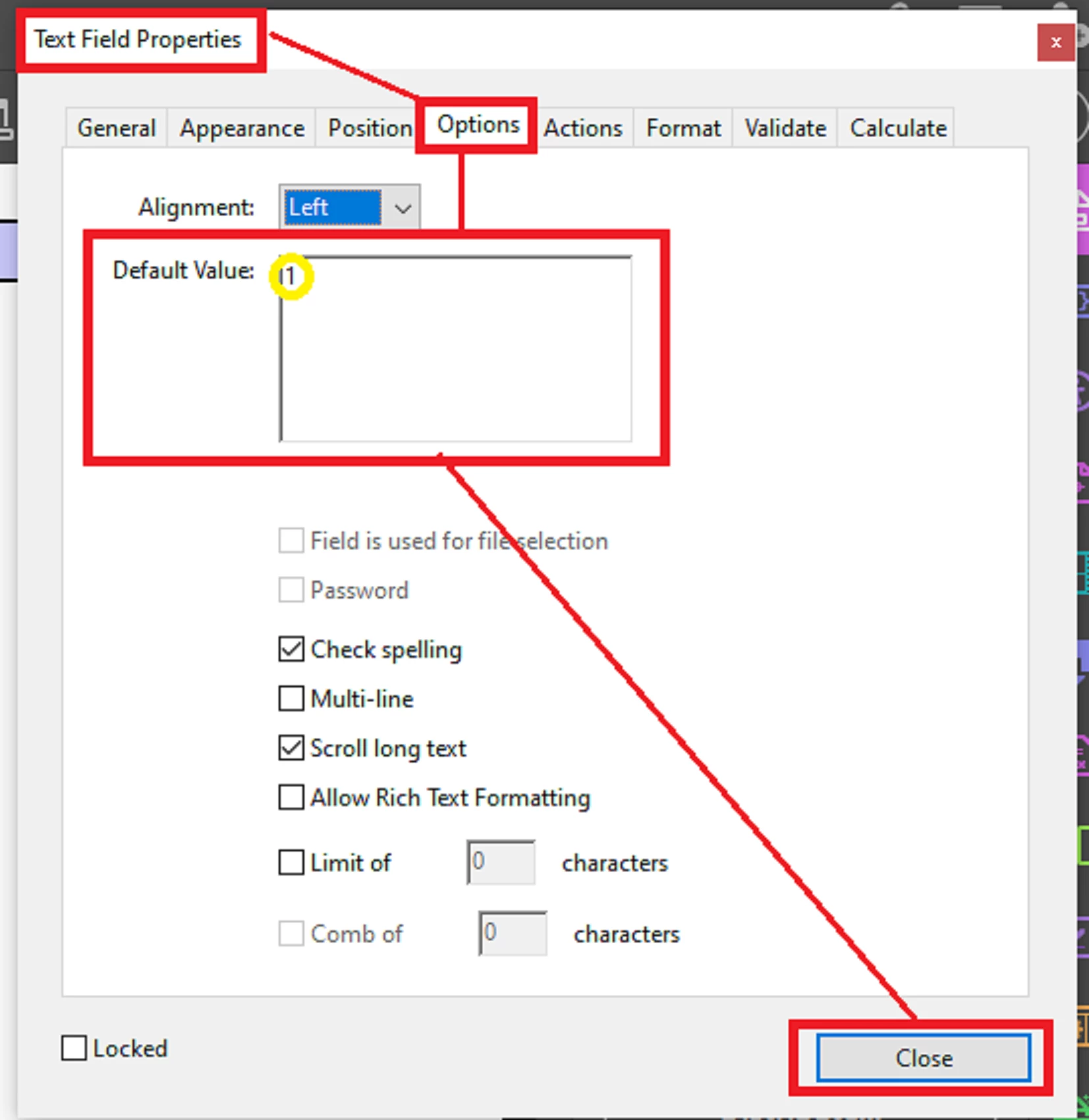

September 15, 2021
You can try this in different ways using Acrobat JavaScript.
In my example below I declared a default value of "1" for each field that I want to add to my sum calculation. See slide below:
Then add the script below to your "Sum3" texfield as a custom calculation script:
event.value = 0;
  sum = 0;
  for (var i=0; i<8; i++) {
  var f = "Text2";
  var v = this.getField(f+i);
  if (v.valueAsString !=="") {
  sum += v.defaultValue
  event.value = sum;
 NOTE: in this line  for (var i=0; i<8; i++) , specifically this part: "i  < 8"
Based on your screen shot,  you have a total of eight textfields and they all are in the range from 20  to 28.
If you have more than 8 text fields that you wish to add to your sum operation, you must declare that total in the line indicated on my note above. Otherwise  this script won't work with the "for loop" operation.
For example, if you have a total of 19 textfields  you must indicate "i < 19".
And if that would be the case,  consider working around the field name in this variable:  var f = "Text2".
In which case, if you have textfield names in the range of "Text10" overlapping with those in the range of 20 (all the way up to  "Text28"), then  variable "f" (in my example script above) must be declared slightly different or come up with a different SUM script.

I think they basically just want to count the number of fields that are filled-in, with any value, not sum them up as numbers. So applying "1" as the default value is not going to work...
try67
September 15, 2021
Ah, I see you're using that in your code to count the fields, which will work, but is not really needed. Why not simply increment the value of sum by 1, and leave the default value empty? The problem with setting it as "1" is that if the user clears the form all of these fields will revert to that value...
