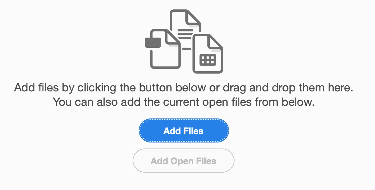

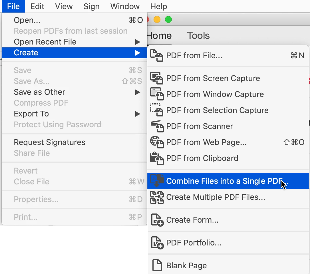

Assuming that you have all of the resultant files in a folder, then in Acrobat go to:
In the next window, click on the top button to select the folder that your files are contained in. (Note: this is the same window you'll see if you select the Combine Files Tool)

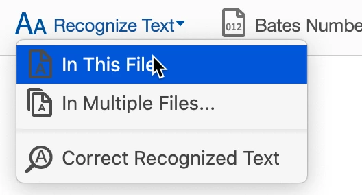

Now, if you saved the images as TIF files, when you combine them, they will automatically be OCRed as well. If you saved them as JPG images, you will need to do one more step.
After converting the images into the PDF, while the document is still open in Acrobat Pro DC, go to the Scan & OCR Tool and select Recognize Text and from the dropdown select In This File.
You will need to click on the Recognize Text button that will then appear. Then wait for it to complete and you're done. Do save it with an appropriate name.
