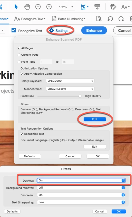

Hi Ellbie,
OK, this is a bit burried but fairly straightforward.
Go into the Scan & OCR Toolset. I've marked the sections you need to adjust in red.
From the top, click on Settings, this will open the Enhance Scanned PDF window.
Then about 2/3rds the way down you'll see the Filters option, click on the Edit button
Here, the very top Filter is Deskew, it's default is on, change that to Off,
Close everything back up and please let us know this works for you.
BTW, you will have to undo this if you're scanning a regular text document becuase it's better that this is on for regular documents as any skewing in text can affect the quality of the OCR.

Thanks Gary.
I managed to find the choices that you have in your image.  They don't appear at all when running 'Recognize text in multiple files'.  I had to open a multi-page pdf file, click on the Scan and OCR tool, and select Enhance instead of Recognize Text.  Hopefully, that selection sticks.  I will respond if I still have issues with skewing in the future.
