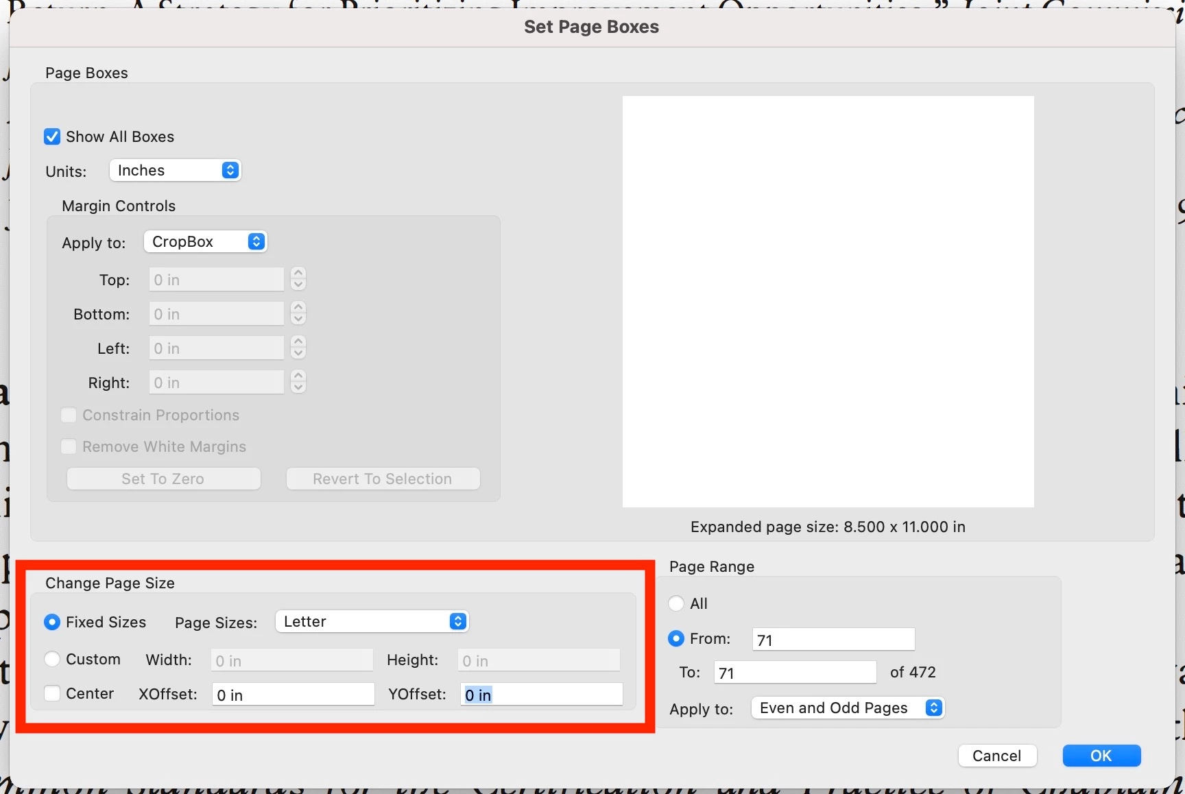

Within Acrobat Pro’s Crop function, there is a “Change Page Size” feature that allows you to adjust the actual document size to anything larger than the current document size. For example, if you have an oddly sized 6.73” x 9.33” PDF, the “Change Page Size” feature allows you to convert it to a 8.5” x 11” letter size. For visual reference, this feature is located here in the red box within Acrobat's crop window:

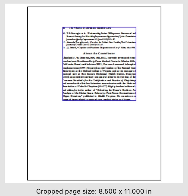

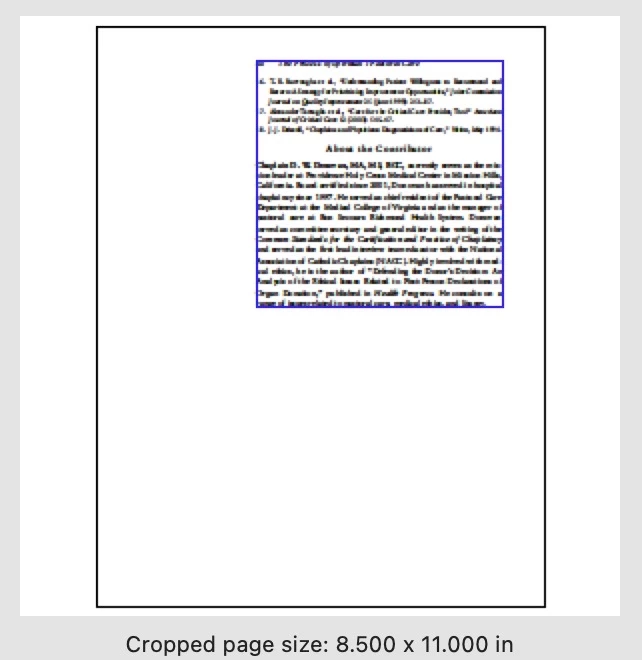

PROBLEM: After recently “upgrading” from Acrobat Pro XI to DC, the “Change Page Size” function has stopped centering the content of the PDF, no matter how the setting are arranged. For example, even if you have a 100-page PDF prepared with accurately cropped bounding boxes with zero margins (i.e., no hidden content), changing to a larger page size results in every page being erratically off-center, and not even in a consistent fashion. Below you will see two attempts to use this feature (both with and without the “Center” box checked), both of which result in bizarrely off-center spacing. For larger documents, this renders the entire purpose of this feature truly pointless, and forces you to manually adjust *every* page’s crop settings to have their text margins aligned.

I know there are a lot of obvious troubleshoots and potential issues that might potentially cause a centering issue, but I am incredibly fastidious about managing them: [1] I use a custom preflight that crop’s a document’s margins perfectly to its bounding box first, and then deletes all hidden marginal data. This means that the “Change Page Size” feature is not getting screwed up by a hidden misalignment. [2] Previously in Acrobat XI, the ideal setting for centered re-sizing was to check the “center” box, and then to have the “XOffset” and “YOffsset” values set to “nan in,” which is the mathematical placeholder for “not a number.” From what I understand, this was Adobe’s way of preventing division by zero, while also allowing you to tell it to center the page vertically and horizontally to a zero offset. In Acrobat DC, the “nan in” option does not work, and the closest you can do is to enter “0.01 in” for the values, except this still yields wildly off-center results.
